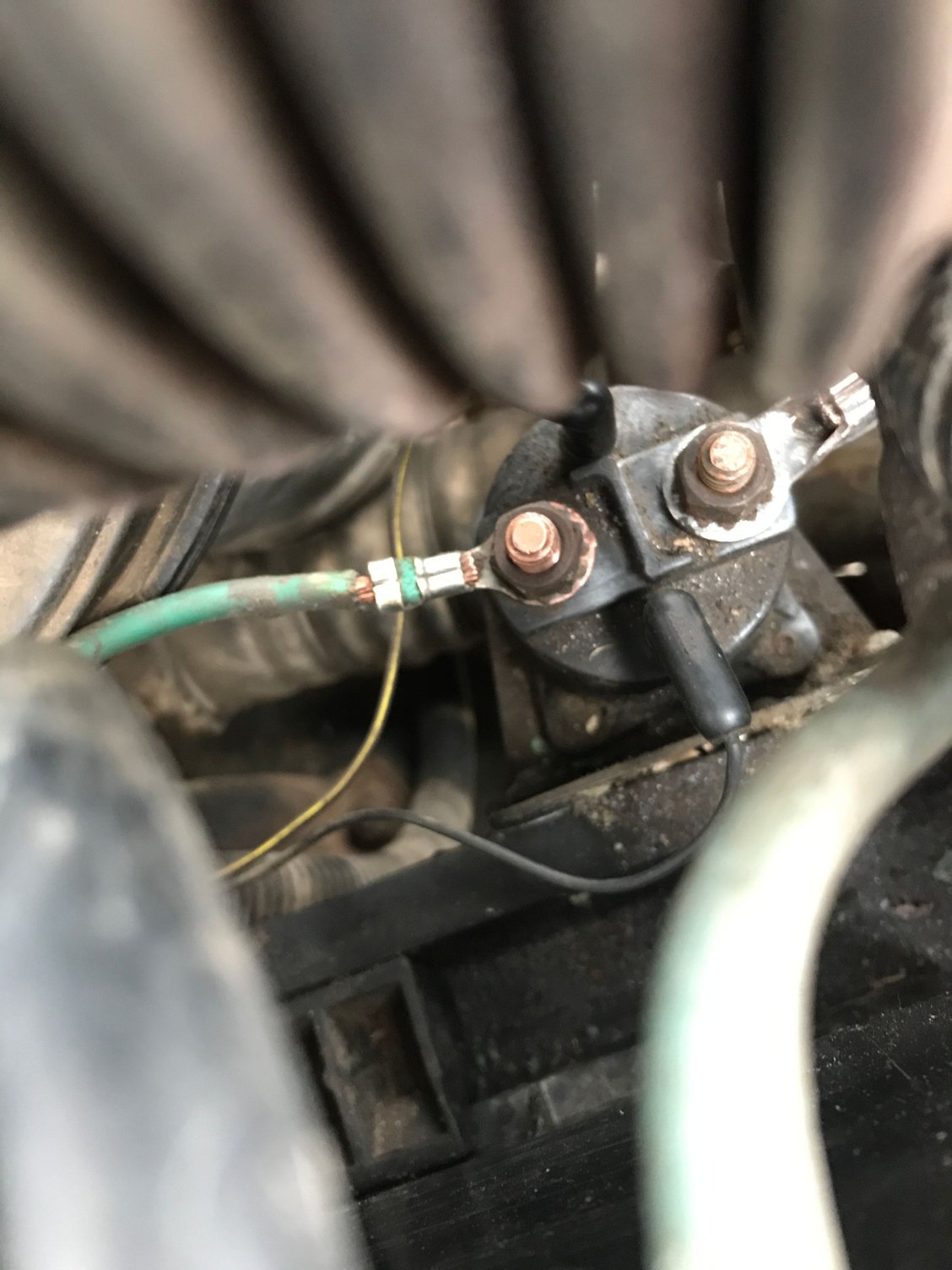

What voltage should it charge at? Mine is 15.5 now. It was burning up right side battery. Cleaned all terminals . What is this compo
What is it?
nent

That appears to be one of the two grid heater relays. Follow the wire, does it lead to the grid heater on the intake manifold?

Yes, but there is only one on this truck.
