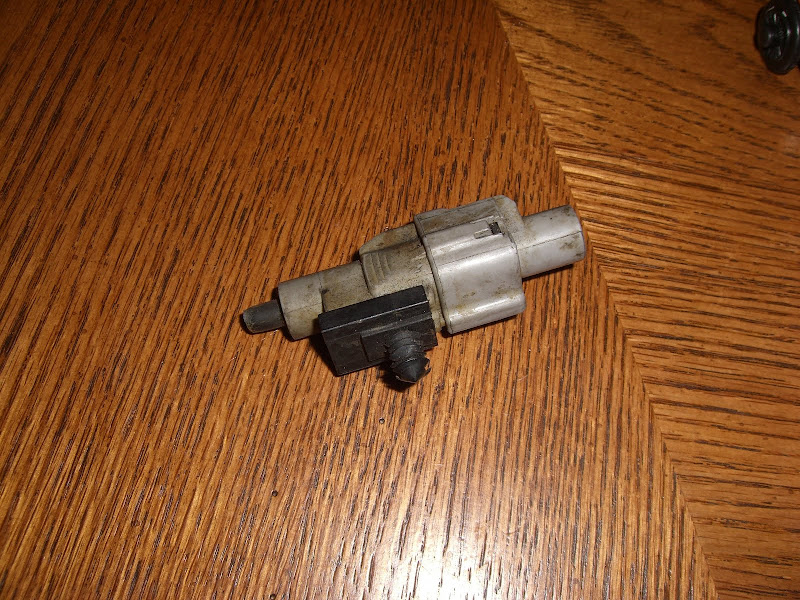

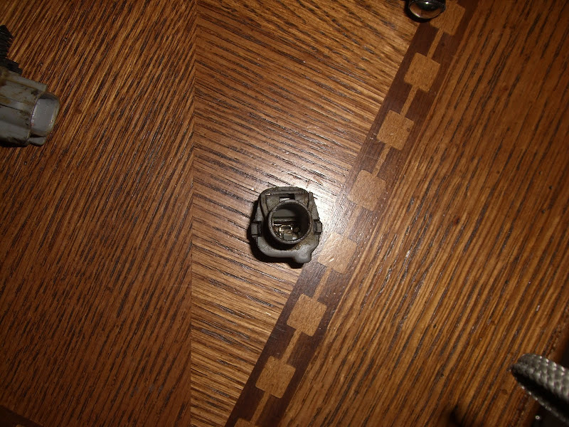

I did have two problems. The first was an electrical problem that killed my vp. I replaced the vp44 and put an airdog 150 on it. This got me back running but still would die out over bumps. After chasing wires and cleaning plugs I found that one of the leads off the pass. battery ground had a bad connector. I finaly got it running yesterday.
