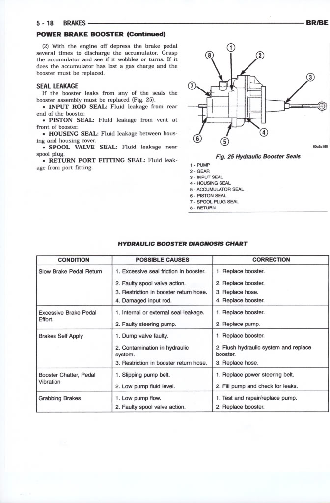

Old Jun 8, 2010 | 08:09 PM
nickg's Avatar
Posts: 2,435
From: Edmonton Alberta
