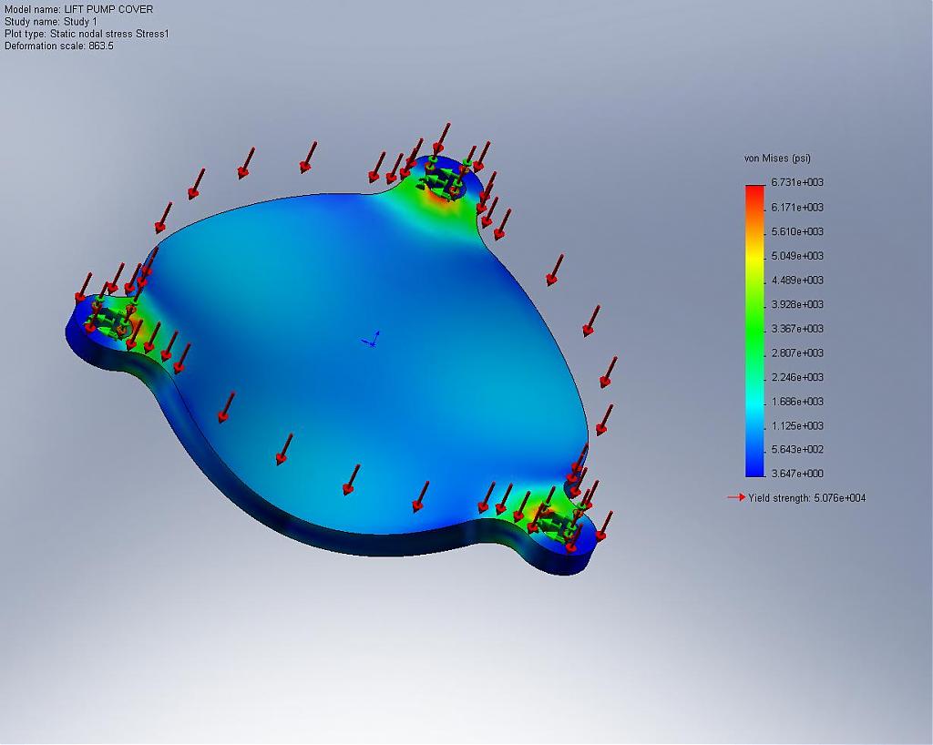

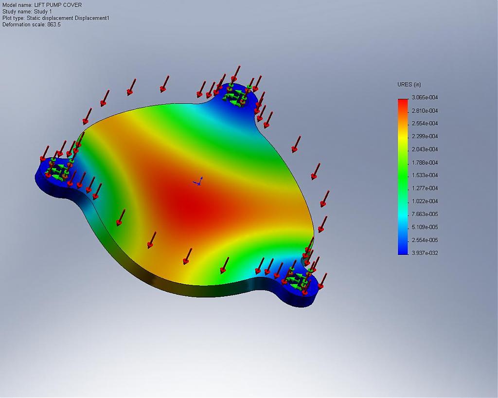

Somewhere above there was mention of the cover deflection. I just ran Cosmos stress analysis on an approxomation of the cover as I don't have a loose one for real dimentions. If someone can send me a sketch I'll run it again. Simply put deflection is not an issue.
We're looking at about .0003 in the middle worst case. I doubt the cover is even that flat to begin with.
