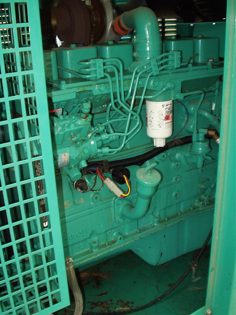

Here is a picture of the fuel system on a generator set placed into service October of 2000:
Attachment 12983
That is not a 24 valve engine.,,,
