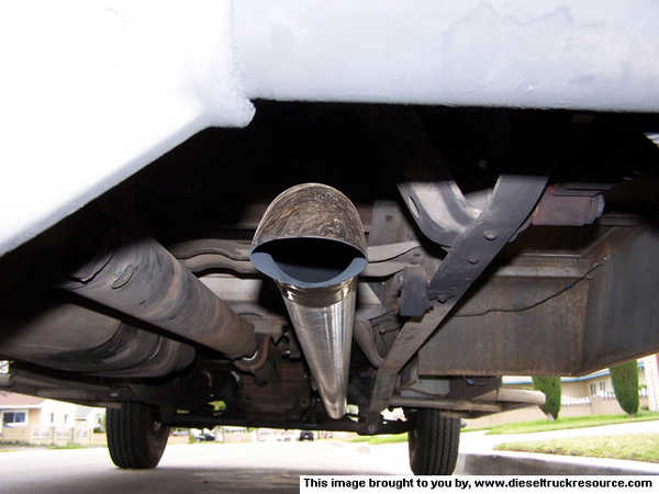

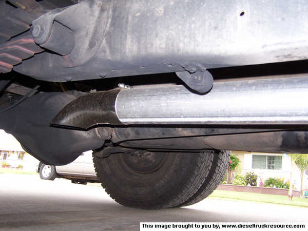

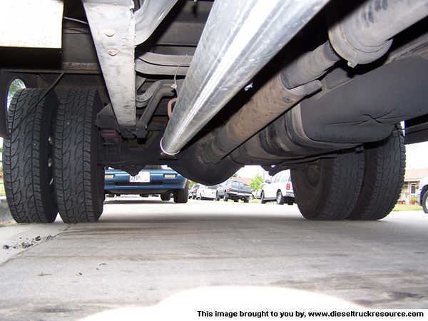

just do a 4" to a turn down near the rear end. no bends required except for a downpipe fab if you even do that. you can build off of the source automotive downpipe.
gives everything a nice coating of soot
you darn 2wd guys got it too easy!
Also heats up the rear.....
