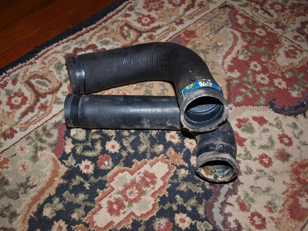

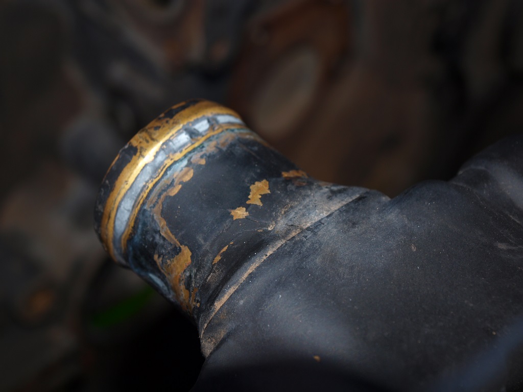

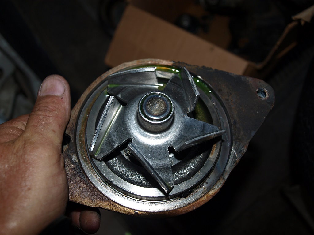

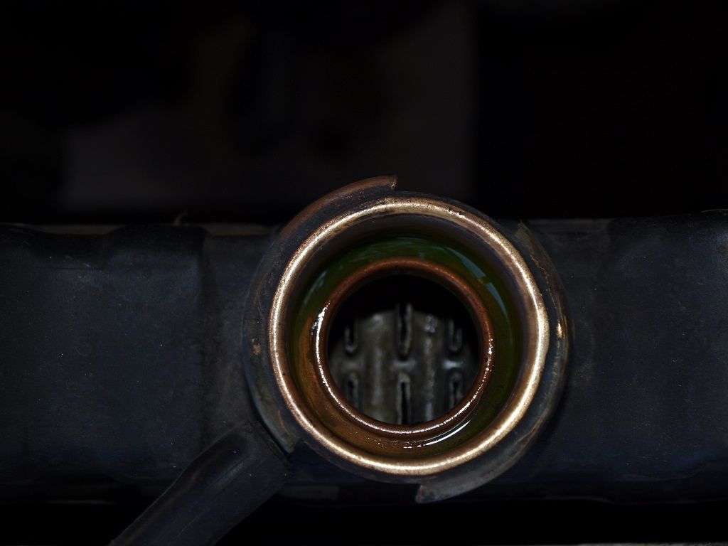

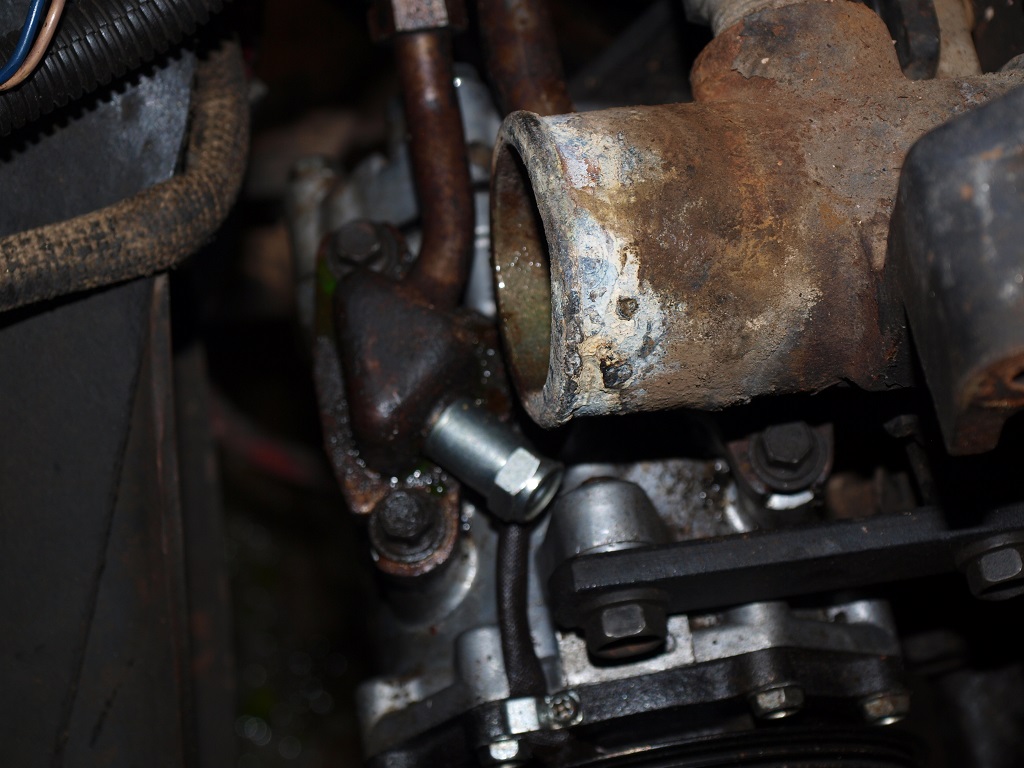

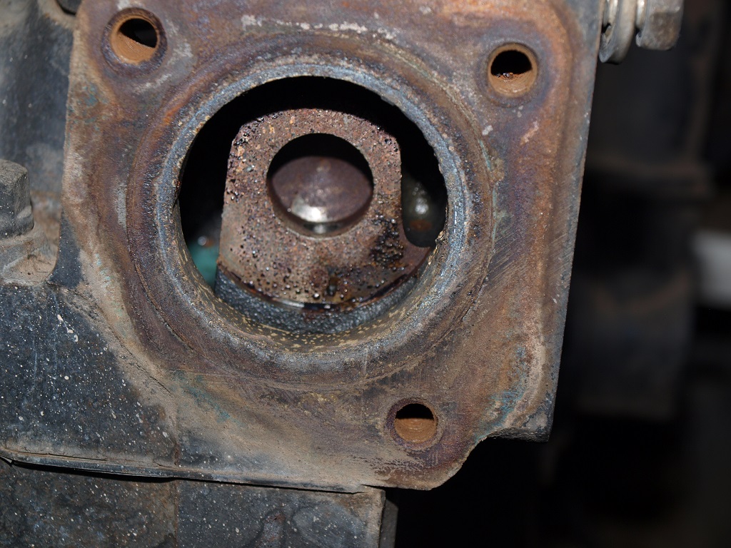

I hesitate to bring this up, because it seems to get people riled up for some reason. I really only want to show why I do it, all those reasons why I shouldn't have been duly noted and are not necessary here. I last changed my anti-freeze in 2005 (I think). I decided to change it, as well as the water pump, thermostat, hoses and cap. The truth is that none of it was necessary, but I feel obligated to change it because it has been so long. Anyway the lack of corrosion is why I never add water to the coolant. All the pics are without any type of cleaning...Mark
Attached Thumbnails This is why I never add water to anti-freeze-no-corrosion-down-radiator.jpg   This is why I never add water to anti-freeze-no-corrosion-lower-inlet-engine.jpg   This is why I never add water to anti-freeze-no-corrosion-thermostat.jpg   This is why I never add water to anti-freeze-no-corrosion-upper-radiator.jpg   This is why I never add water to anti-freeze-no-corrosion-water-pump.jpg

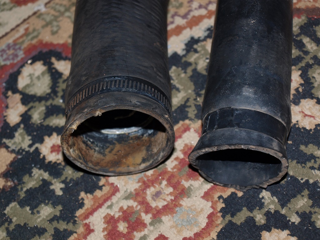

The coolant capacity of the engine is about 6 gallons. Just draining out the petcock drained around 4 gallons, I bought 3 gallons new and reused about a gallon of the old coolant. I put the rest of it in the containers and have it in my rig for emergencies...Mark
Attached Thumbnails This is why I never add water to anti-freeze-no-corrosion-hoses-1.jpg   This is why I never add water to anti-freeze-no-corrosion-hoses.jpg

The water here is heavily mineralized and leaves all kinds of corrosion. It is probably lots better where there is much softer water...Mark

That would be nice, water that doesn't corrode. I don't know anyone that has put RO distilled water in their system here, but I have seen the results of running too much tap water and it isn't pretty...Mark
