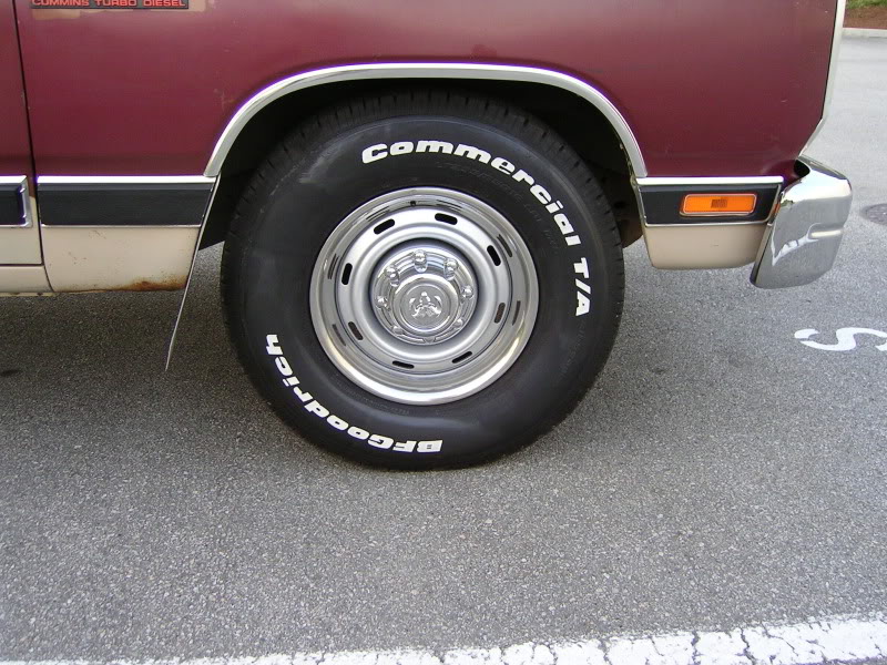

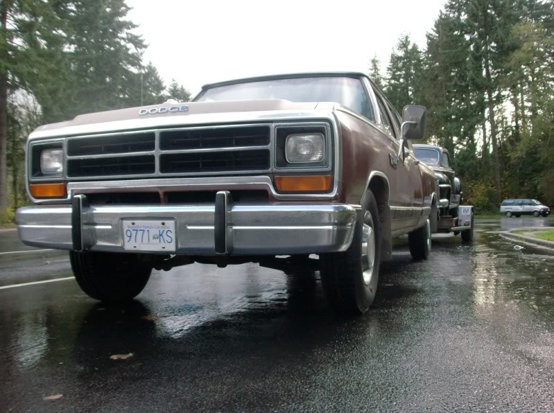

They are a great Hwy tire. I run them at 85lbs air, yes a little rougher at that pressure but I get better mileage. Winter I throw in 6-800lbs of sand bags in the back and away I go. I have a set of cable chains behind the seat if the roads get really bad.
I chose them after much research, here on the DTR, and other On-line sources. I wanted decent traction, but also to maximize my fuel economy and have decent/good wear properties. I think these have provided me with everything I wanted.
Here's a couple pics...

I will be getting a pair of the BFG Commercial TA Traction for the 1990's rears. Mounting them on 16x7 Ford steels. Will report on their performance v. expectations.
