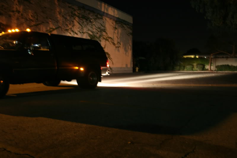

Here is what the back of my truck looks like at night.
Here I found a nice dark place near where I live.

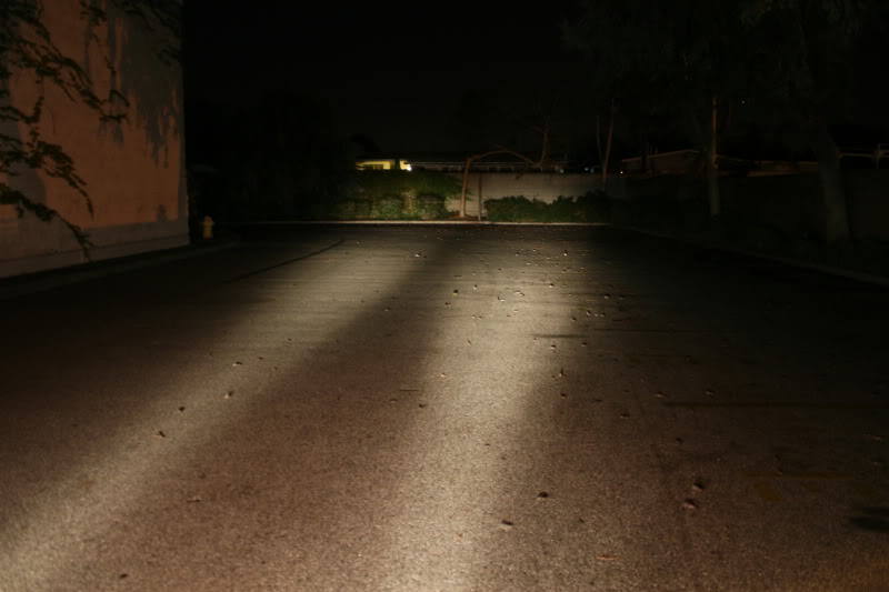

With the engine idling, I flip on the override switch in the cab, and the night becomes daylight.
Here is a side shot to show the spill from under the bumper and up the wall.
And another one

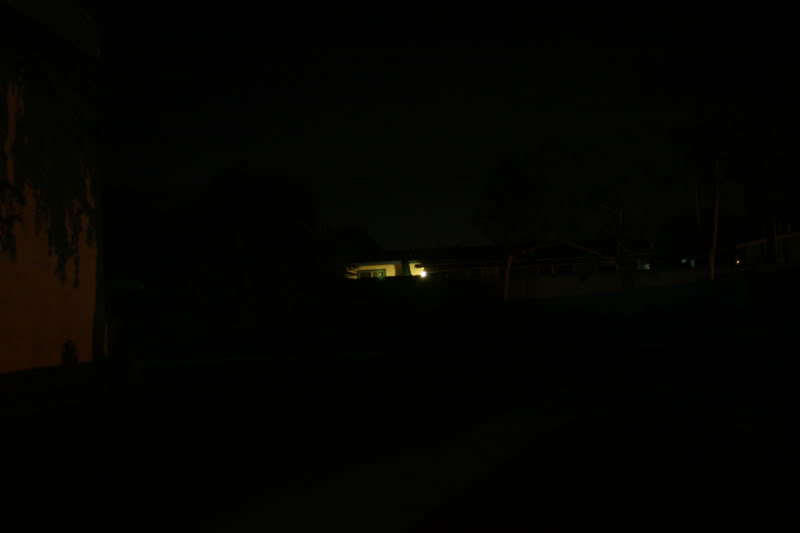

Here is looking at the back of the truck with the backup lights on, see how useless the factory ones are.
The first 3 and the last picture are taken with Canon DSLR handheld with an exposure of 60th/sec @ 3.5 so they are the actual light output, pictures number 4 & 5 were taken with an exposure of 50th/sec @3.5 so the light is very slightly exaggerated but I did this to show you the beam pattern.
The actual top cutoff of the beam is 75' behind the truck as required in the vehicle code.
http://www.dmv.ca.gov/pubs/vctop/d12/vc24606.htm
Also as far as mounting lamps to the real axle you might want to check its legality in your particular state.
It is illegal here in California.
Would you believe that as bright and noticeable as these lights are along with how quiet my truck is, when I am backing out of parkings at stores there are still people who will walk directly behind me dragging their kids tempting their fate.
This is when I give a little toot with my air horn to let them know that I saw them.
Jim
