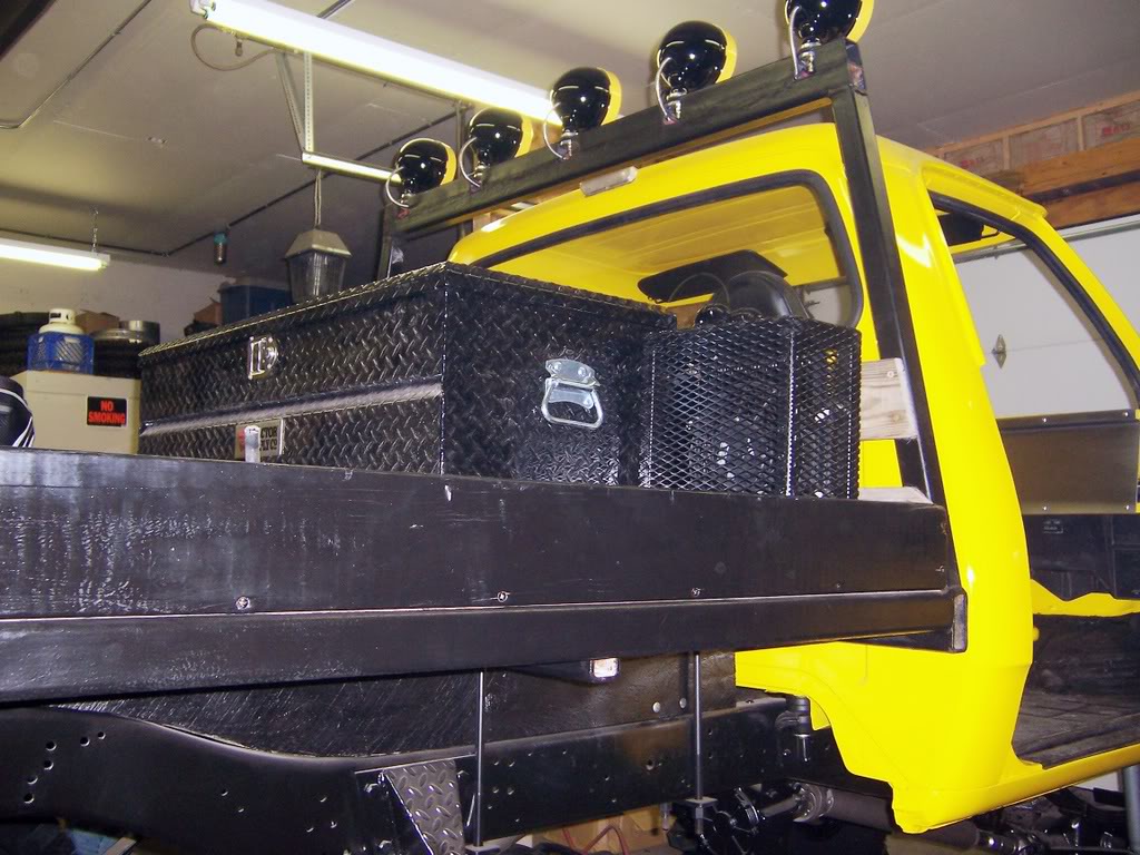

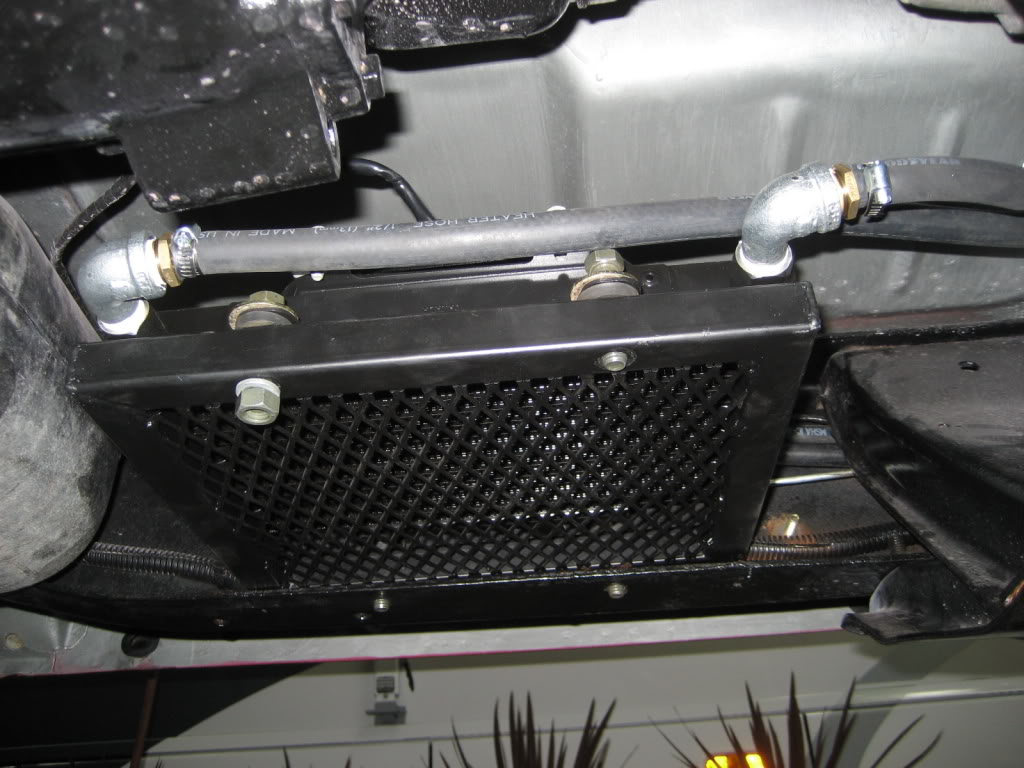

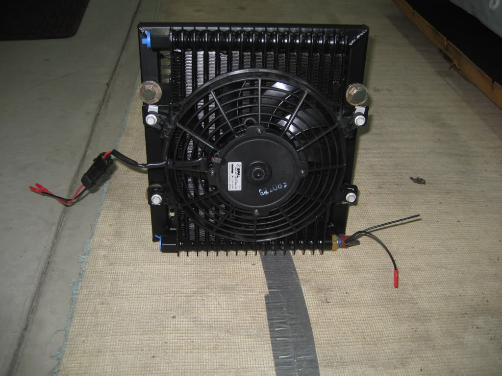

Here is a few pics of my under the bed trans cooler, and I also included a pic of the same cooler mounted on my flatbed of my wheelin truck. On my 92 I am running the heat exchanger still. Fluid goes out of the trans, to the exchanger, exchanger to the my under the bed cooler back to the trans.
