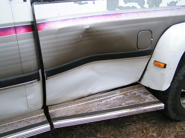

I wonder how fast that old girl was going. I was probably doing about 40 and sliding when we hit. Bumper cracked the head. Plastic got fuddled on the left front corner, turn signal, headlight trim, and grill. Sheet metal looks fine. Her ****, on the other hand, caved in the side of the box about 3 inches, cracked the fender, and took off the back half of the running board.
Expensive meat, hope it's good.
