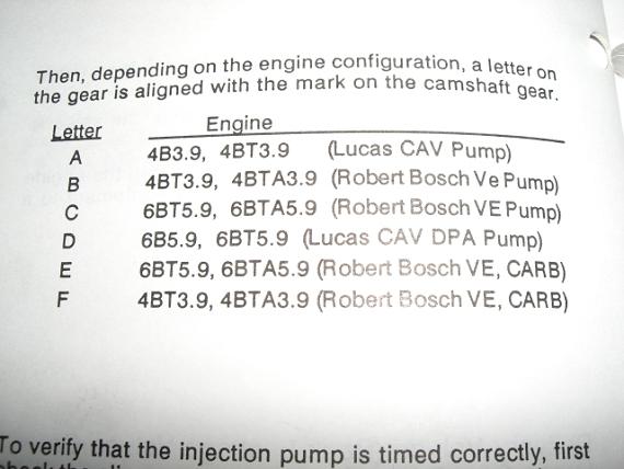

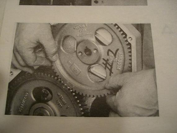

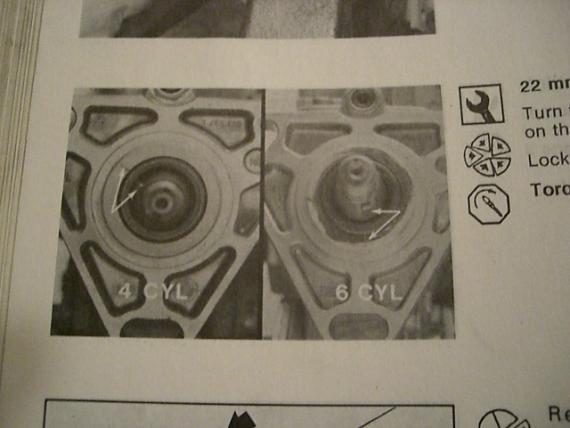

Does anyone have a picture or know how to align the marks on the cam and IP gear?
Thank You.
Old Feb 24, 2009 | 02:26 PM
CrewCab59's Avatar
Posts: 14
This should do it
Attached Thumbnails Timing-bosch-injection-ve-letters.jpg   Timing-ve-came-gear-pump-gear.jpg   Timing-ve-hash-marks.jpg
