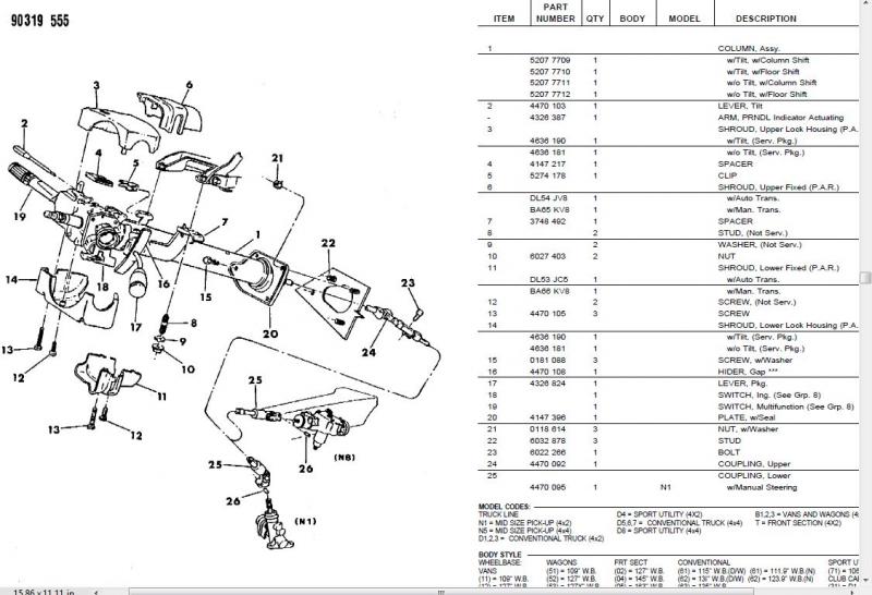

Here's a screen snip from a PDF file I have 1st Gen part numbers....

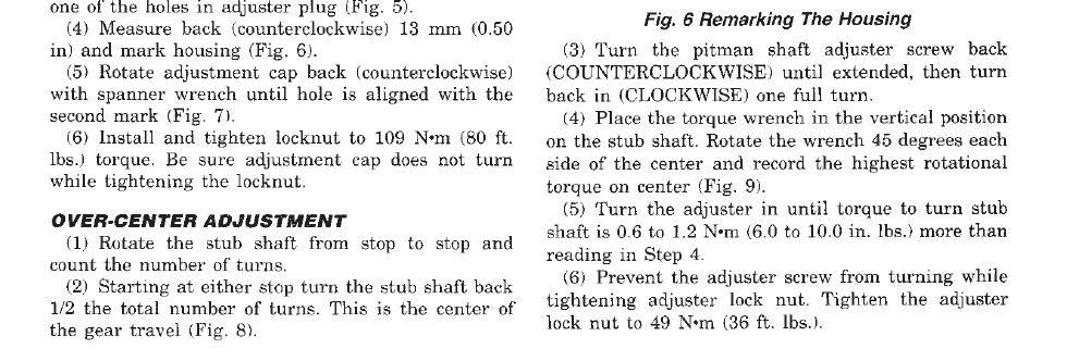

The second one is right. However, which would be easier once the pitman arm is off? Remove the sector, or remove the steering column?
The adjustment is called "over center". Here's a screen grab from the manual.
