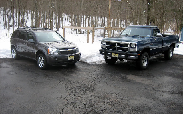

Ha...yeah, here's how it went down.
I was parked in a lot, I rolled it backwards, hoping to get enough momentum to start it, but no go. I turned the wheels and hooked the camo strap on my hitch, and tied it around the Equinox hitch and had my wife pull me backwards, so we could get a fair shot at a little straight-away.
Then I untied her, had her reposition in front of my truck, and wrapped the strap around the front axle and re-tied to her hitch.
She did a great job, didn't stress out like usual, and it only took about 10 feet to get up to a speed to pop the clutch in 3rd and away she went.
That auto to manual swap is finally paying off!
Best friends!

Man that's an ugly truck! When you come to your senses and decide to get rid of it let me know. I think these trucks all take better photos when there's snow in the background.
