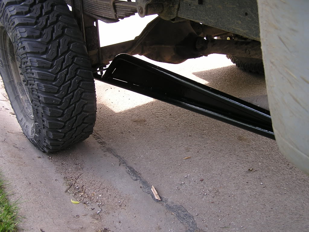

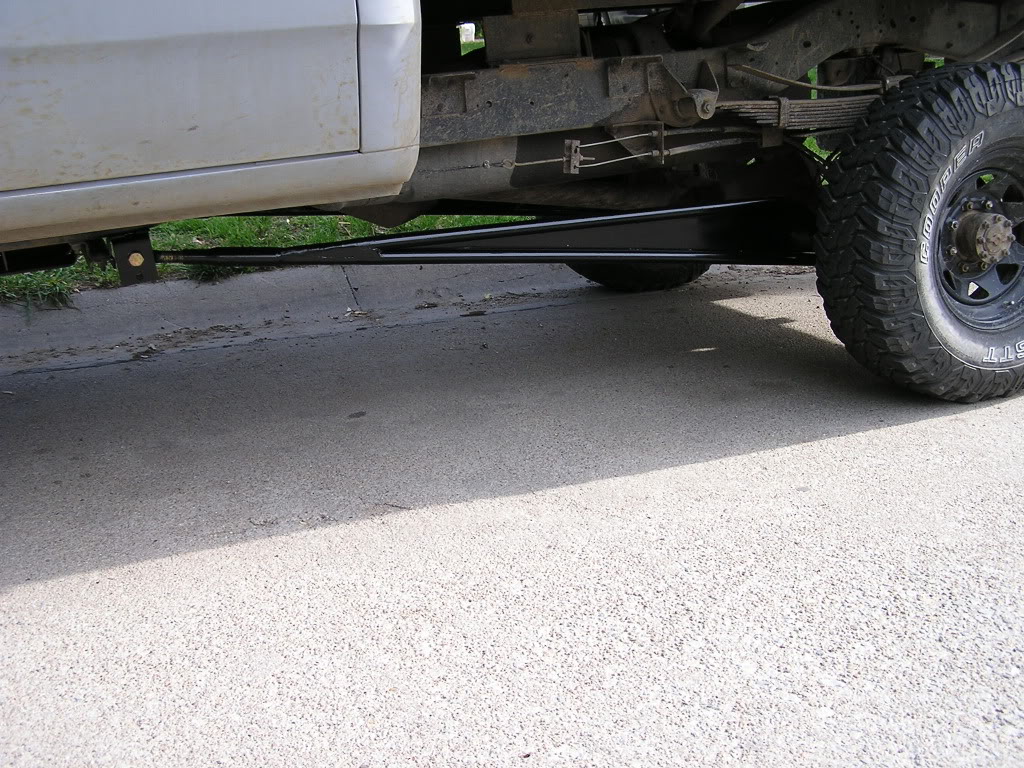

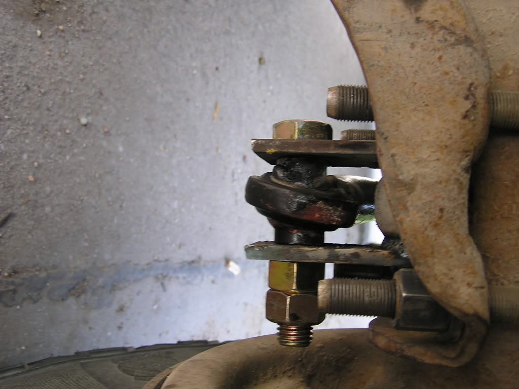

I just put traction bars on mine, It made a big difference.
Did you make them yourself or buy them from a business? They look nice!
Could you snap a picture on how you tied it into the spring perch ?

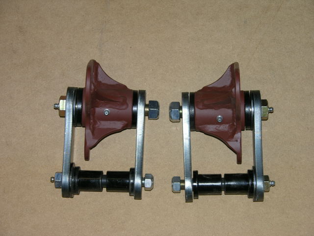

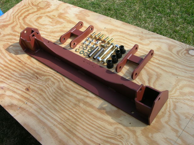

For raising up the front how about something like this. The front drop hanger is made in 1" drop, 2" drop, 4" drop & 5" drop. They are supplied with matching shackles to keep the steering geometry the same. The last 2 pics is the front spring rear frame HD bushing repair kit to git rid of the wimpy OEM bushings & carry the weight of the CTD.
Jim
Me and my dad made them.
Here's that pic, roxxx. I upgraded to 5/8 U bolts when I did it.
Jim
The Pics didn't work the first time
Attached Thumbnails Skyjacker front springs, good or bad?-image0009.jpg   Skyjacker front springs, good or bad?-image0010.jpg   Skyjacker front springs, good or bad?-image0013.jpg   Skyjacker front springs, good or bad?-image0011.jpg   Skyjacker front springs, good or bad?-image0012.jpg
