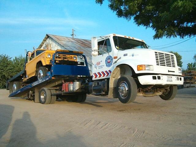

Can any of you identify the model of John Deere on the trailer?

From what I can remember, that looks like a mid-40s Model D? Or am I way off?

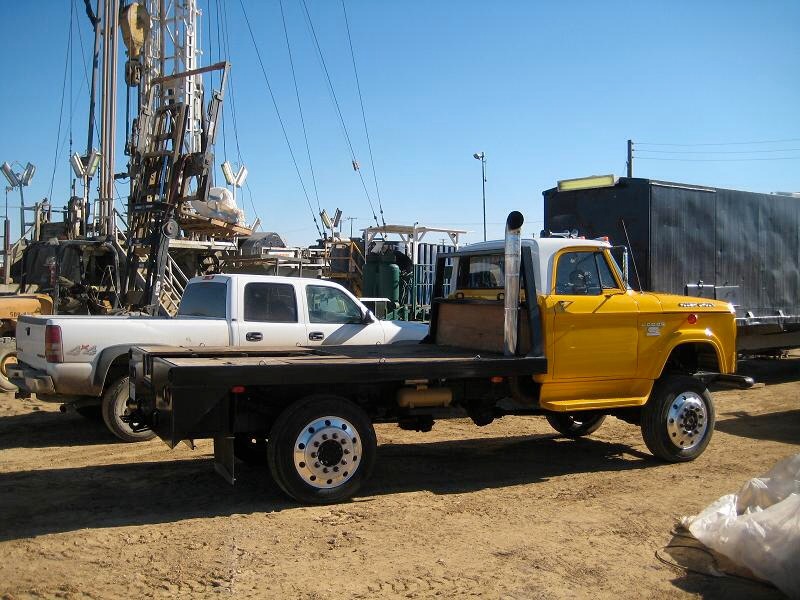

It's a 1968 W300. I first restored the truck as a regular cab. But there was not enough cab room so I cut the back of the cab off and slid it back 2'. While the cab was off I mounted it on a cab air ride system. Also took out the 10 speed so the Mrs. could drive. The video shows how cramped the cab was. Especially since the firewall was cut back 9" to give room for the '93 Cummins. Now I can slide and lean the seats back.

I went through a couple of your threads and watched your videos last night. Very sweet build! But what model john deere was on the trailer that you posted in this thread?

was that an old Sothern California Edison Co. truck?

Thanks Guys, lots of hrs making it an extended cab. In order to make the chassis longer the back half is '01 F350. Which made my life a lot easier getting rid of the old drum brakes. That's why I went with truck wheels. The ford Dana 8 lug is metric and the GM 8 lug is standard. There's 2 metric adaptor sand two standard. Now the tires can be rotated.
That's a 1946 John Deere D. 501 cubic inch 2 cylinder.
Good eye yes the truck use to be an Edison power line truck.
