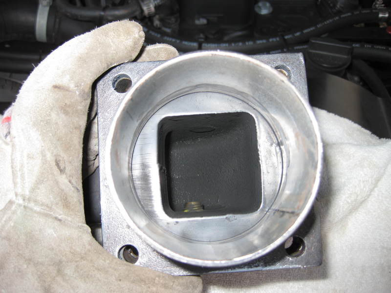

Here you can see how much larger my custom flange is that the size of the stock crossover pipe, in addition to the restrictive size there is also the friction losses of the rough casting and abrupt turns.

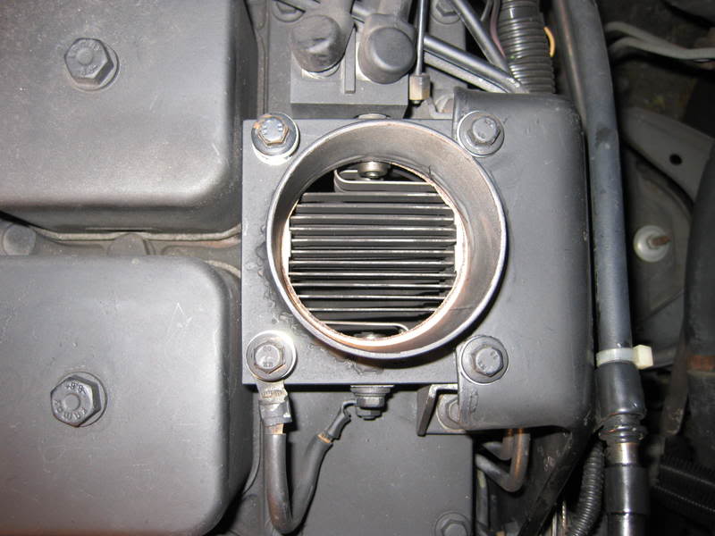

Here is my flange installed on the grid heater, it is now a direct path into the manifold.

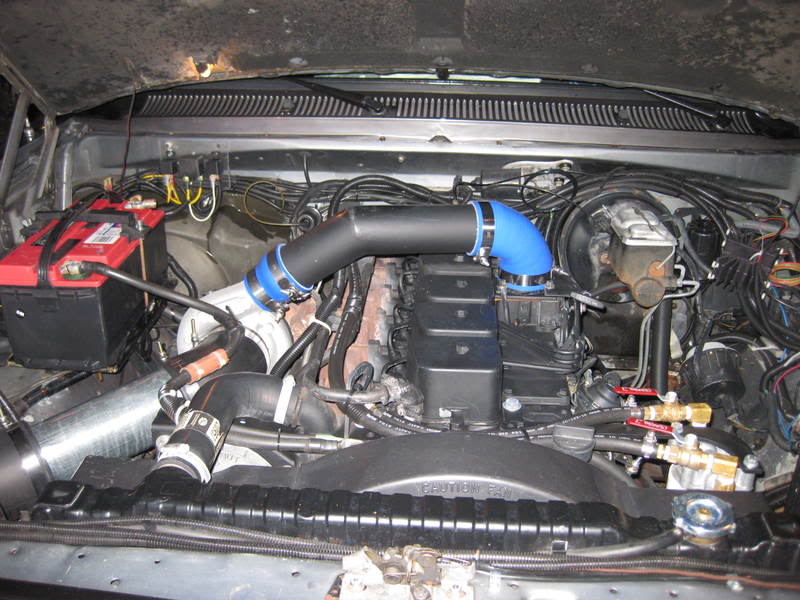

This is how I made my pipe, instead of bending the 3” tubing I made several cuts and then welded the sections back in at a different angle, the bender crushes down the I.D. of the pipe where it is bent so I would loose the smooth airflow.
This was my first pipe but I want to remake it so I can get it lower over the exhaust manifold as it rides in the hood insulation, I can reuse this one if I weld a small section onto the right side and trim down the left side and simply rotate the turbo housing.
