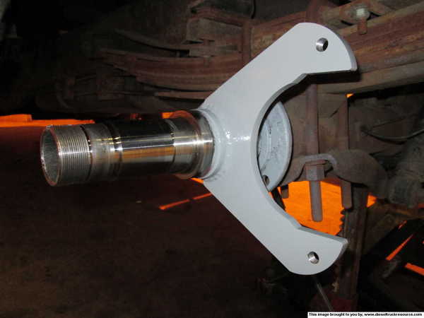

Finally did the rear disc brake conversion, I'm very happy with it.
Definately worth doing.

-used weld on brackets
-1976 Caddilac Eldorado calipers with e brake and braided lines
-80's chev 4X4 rotors
-new e brake cables
Fairly easy actually, take the drum and hub off then press out the studs to separate drum from hub, unbolt the old backing plate.
-install rotor onto hub and press in the studs.
(might have to oversize the stud hole a little on the rotor)
-put the hub and rotor on the axle
-install the pads into the caliper and bolt the caliper onto the new bracket.
-get a grease gun hose and put on a fitting to connect to your compressed
air source, the other end of the greasegun hose will screw into the caliper.
-put the caliper on the rotor and position it where you want it, hook up
the compressed air, the caliper will engage the rotor and now your bracket will be lined up on the axle tube.
-tack weld the bracket.
-remove the caliper and rotor/hub, weld on your bracket.
( I brought in a pro welder for this job )
-clean things up, a little spray paint, then put your hub/rotor back on
-Install the caliper
- I used new Dodge e brake cables, found out that they will adapt easier if
I put them on backwards (front to back)
- The rest is regular brake line and bleeding stuff.

Is the bracket welded to the axle tube, or the brake back plate mounting flange?

The bracket is welded to the tube, backing plate flange no longer used.

on the brackets- what tube diameter do I need? 3.5 inch

I think it was 3.25"
