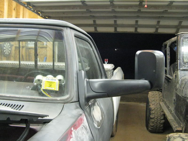

ken, hope you don't mind me stealing your idea and tech!!

Looks good - did you cover the gap with metal, bondo or something else?
Old Mar 10, 2010 | 09:32 PM
getstucksome's Avatar
Posts: 101
From: Raleigh, NC
I used some thin steel I had laying around the garage. I did cut the plastic on the mirrors down and cut into the door to sink it in as far as possible.

not at all..
here are pics of the mirrors mounted on my new 1st gen

So, I am curious, why not mount the mirrors to the door in the factory mounting location rather than over the vent window? I am have looked at all the pictures and sat in my truck trying to visualize it. I think that the passenger side mirror would be high enough to be visible still. You'd still need to box in the mounting to cover the gap, but I think it could be made to look a little more factory that way. Thoughts?

when i held mine up it did not look like i would get the visibility I wanted.

I mounted mine up in/near the vent window also. If mounted in the stock location you'd probably only see 1/2 of the mirror
