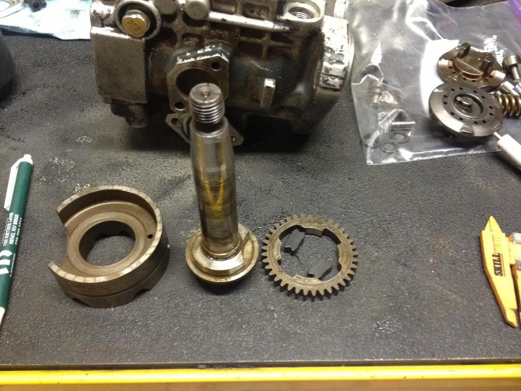

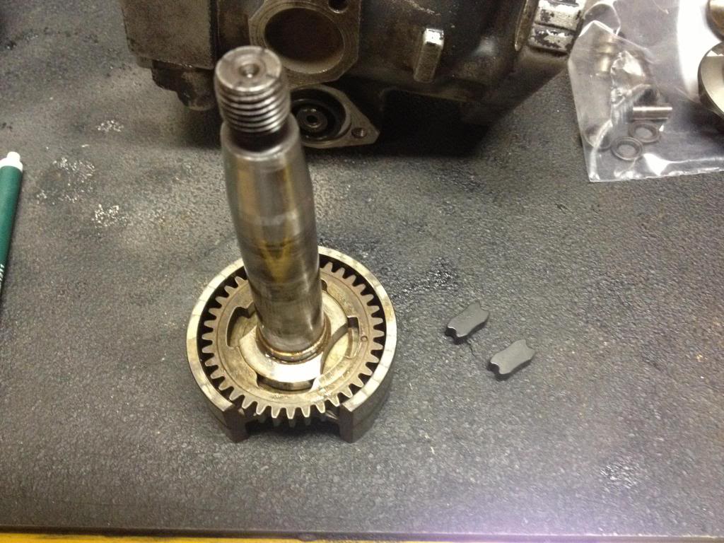

I'm in the middle of resealing my pump, I'm no expert but I'll chime in. The Gov should not spin freely inside the pump, it is directly connected to the main shaft and secured by two little rubber insulators. There will be a small bit of play in the Gov gear as a good set of insulators will absorb a little movement. If those insulators are missing, it will spin freely. If the rubber insulators have come apart and are through out the pump, better pull it apart and clean it out. These pumps are extremely easy to repair. Here are some pics of the gear and insulators.
Hope this helps, Mike.

Ok the pump is in few hundred parts. Findings 1. Minor scaring in pump body. 2. A little bit of rubber fines. 3. A spare part that's chewed up lol! It had to have come out of the top of the pump "investigating that now"! Looks like a 5/16" plug that has a hole in it that takes a Allen wrench to tighten. Maybe from somewhere in the smoke pin area. Chime in and give your opinion where it's from. Anyways that's where I'm at now! Calling Abilene diesel injection in Abilene or Tripletts diesel in Waco to get parts. Oh I had the parts in an old Bosch DGK 121 kit. What luck!!! Again thanks Mike for confirming my problem.
