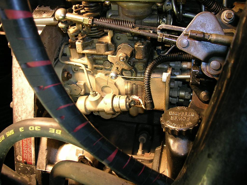

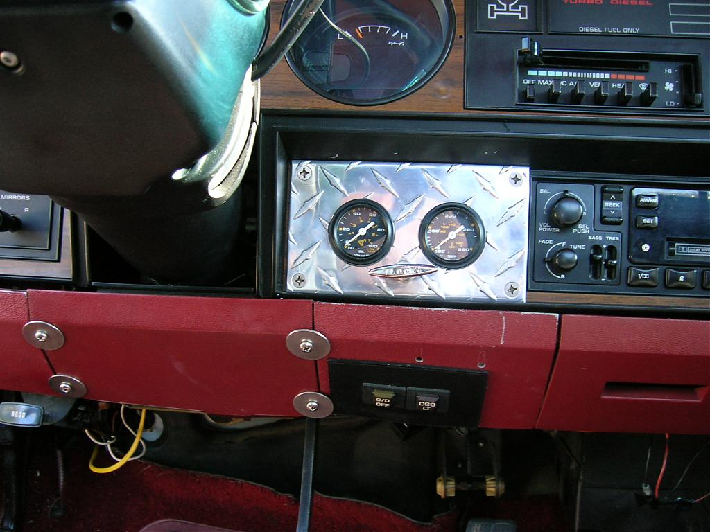

Here is one idea.
Attached Thumbnails Pull Cable-grand-dads-070.jpg   Pull Cable-grand-dads-072.jpg

Originally Posted by dieselJon
Now I want to do the pull cable deal. I have some throttle and choke cables just laying around not doing anything when taken off of something. Do I attach it to the lever on the side of the pump? And what do I do about the shutdown solenoid? Also where is the best place to mount it? Thanks!
Jon
Jon,
I would suggest not to use the choke cable. It was my first cheap fix for shut down and it binded terribly. I kinda went overkill on my present pull cable setup. I installed a "T" pull handle that is part of a drag chute release kit. It's a morse cable and smooth as silk. Go with the throttle cable and I think you'll be good. Like Dave said, attach it to the lever and gut the solenoid. I have my handle mounted at the bottom of the dash next to the trailer brake actuator.
Aloha,
Matt
