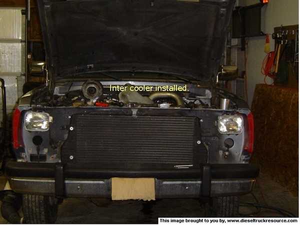

Richie O Thanks for the picks it's a great help. I already removed my ac in the front and I am going to move the other cooler out of the way and I'm going to give it a shot. If it doesn't work I think I'm just going get a IC style rad support and grill but I want to give it a shot first.

Originally Posted by Richie O
I don't think it would be possible to not cut the grill. I have a tube grill on mine and it hits that.
Above is Richie O, P/S intercooler and below..............
https://www.dieseltruckresource.com/...hp?photo=33694
Is my 2nt gen intercooler
