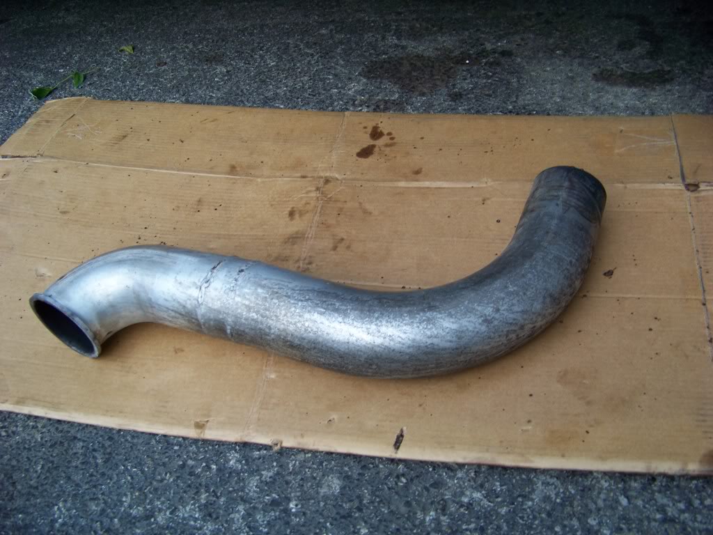

Downpipes are over rated! ha ha just welded a 4" 90 on to the 3rd gen downpipe flange and clamped er on. Turbo install is fairly easy, just need to reclock housings and pull the two studs out of the ehxaust flange with some vice grips and drill the holes a hair bigger to fit our manifolds, and block the wastegate off and its a dang good upgrade.

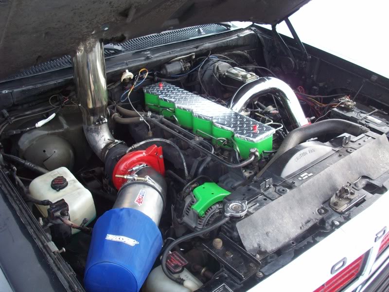

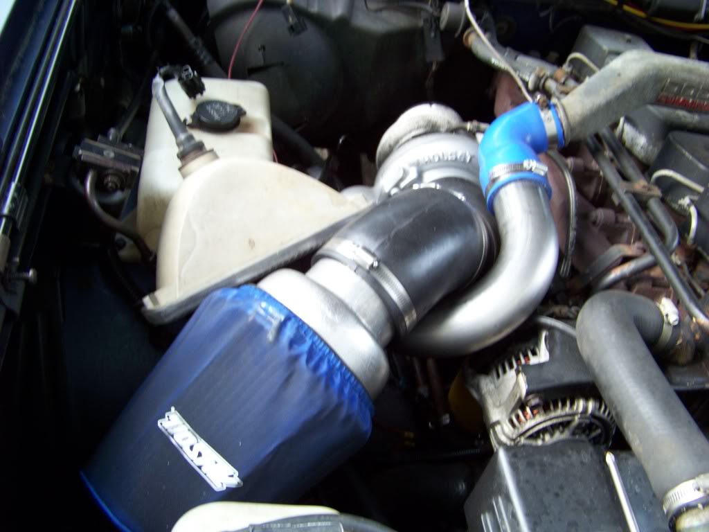

let me search my stuff i have pictures ;-) ....
That should help some... sorry no side picture in engine bay. Custom down pipe with fire-stop wrapped around it.
