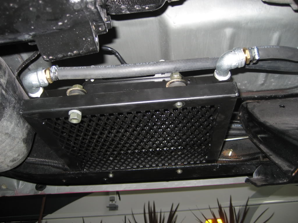

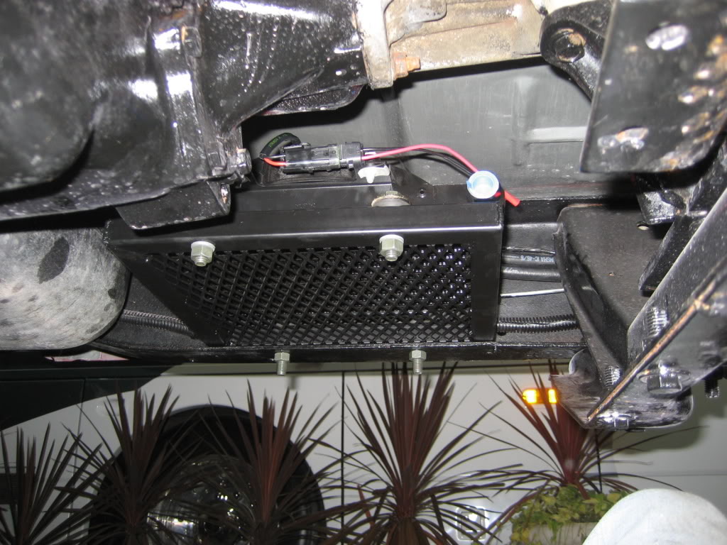

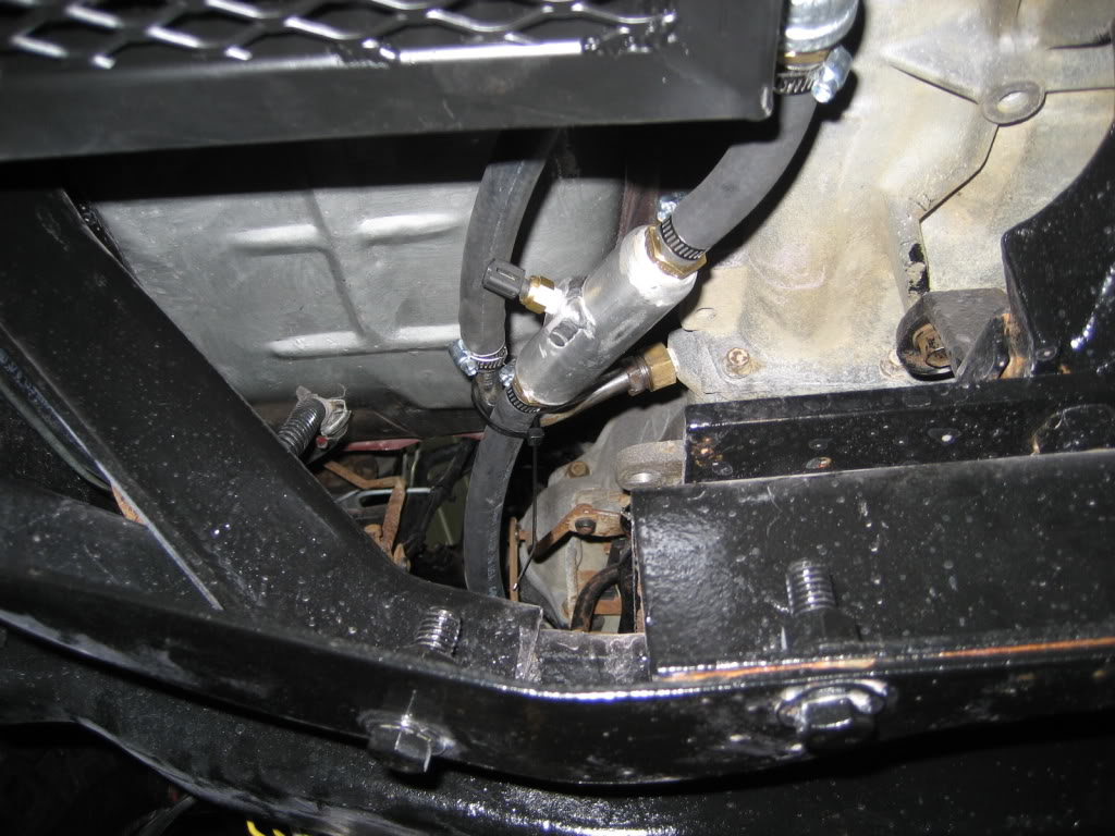

Here's a few pics of my setup. I am using A B&M unit that has 1/2 ports.. I am having issues with the temperature though, fan is supposed to kick on at 175*.. And the guage has read 200 and hasn;t engaged.. So, I don't know, think the guage is crazy, or I might put the guage before it goes to the heat exchanger..
And the heater hose was just temporary. I have replaced it with good hose now..
I like the custom grille you made to protect the cooler, is it supported anywhere other than the frame rail?
What is the cylindrical part next to the transmission? Is it just a chamber for the temp sender?
Jim
