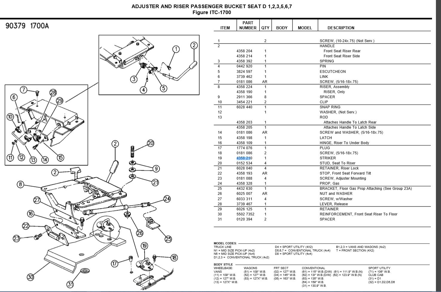

The plastic isolater sleeve which is molded on the latch receiver striker mounted to the floor becomes brittle and falls apart. If I don't have this lined up perfectly, it won't latch.
Now, I can remove it, weld a sleeve to the receiver striker where the plastic isolater is located, but I was curious to know if anyone else has found an innovative way to fix this. Without that plastic piece in place, the seat will not lock down. Eventually, I'll be at that junction. The last RC I saw in a boneyard it was missing its receiver.
ideas ? I thought of taking it to the PC guys who do linex and having them linex the whole top.
Mopar # 4358210
Thanks..

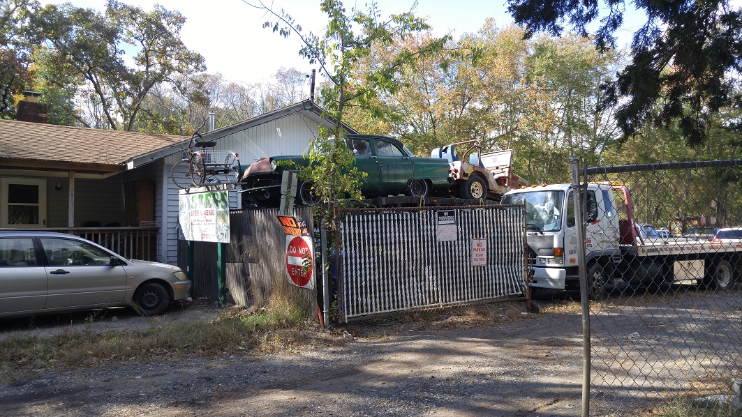

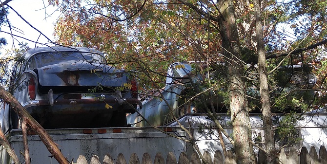

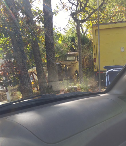

So, today I head to a boneyard I saw a ramcharger in (actually 2), to get my seat striker bracket.
They scrapped both of the RC's.
So I head to a boneyard I've never been to before, out in the middle of nowhere on some long dirt road. This guy has some MAJOR stuff in there. Really rare cars and trucks, plus a couple of RC's. I ask him about it, and he said "NO, I won't sell you the bracket. You have to buy the entire seat. " I told him I didn't need a seat, just the part that bolts to the body. He didn't care.
I say thanks, and move on.
Got none of my money, but it appears he's got gold in there,
Attached Thumbnails Passanger Seat Latch.-1024161417.jpg   Passanger Seat Latch.-1024161417a.jpg   Passanger Seat Latch.-1024161418.jpg   Passanger Seat Latch.-1024161426.jpg
