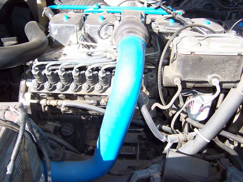

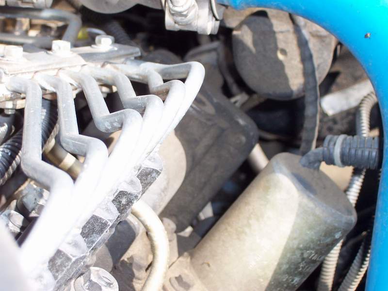

Although my son and I put a complete ('96) P pumped engine in his '90 you can see there is clearance behind the inj pump and brake cyl. So I don't see a problem converting a VE, it's just a matter of having enough of the green stuff......
Attached Thumbnails p-pump converted guys got a Q-96enginea.jpg   p-pump converted guys got a Q-96enginec.jpg

That looks really good in there, nice clean install. Im thinkin I may just pull the motor, and freshen it up while im at it. I spose more then a few of my 337K mile original gaskets need replacing. Thanks for all the info guys, I really appreciate it!
