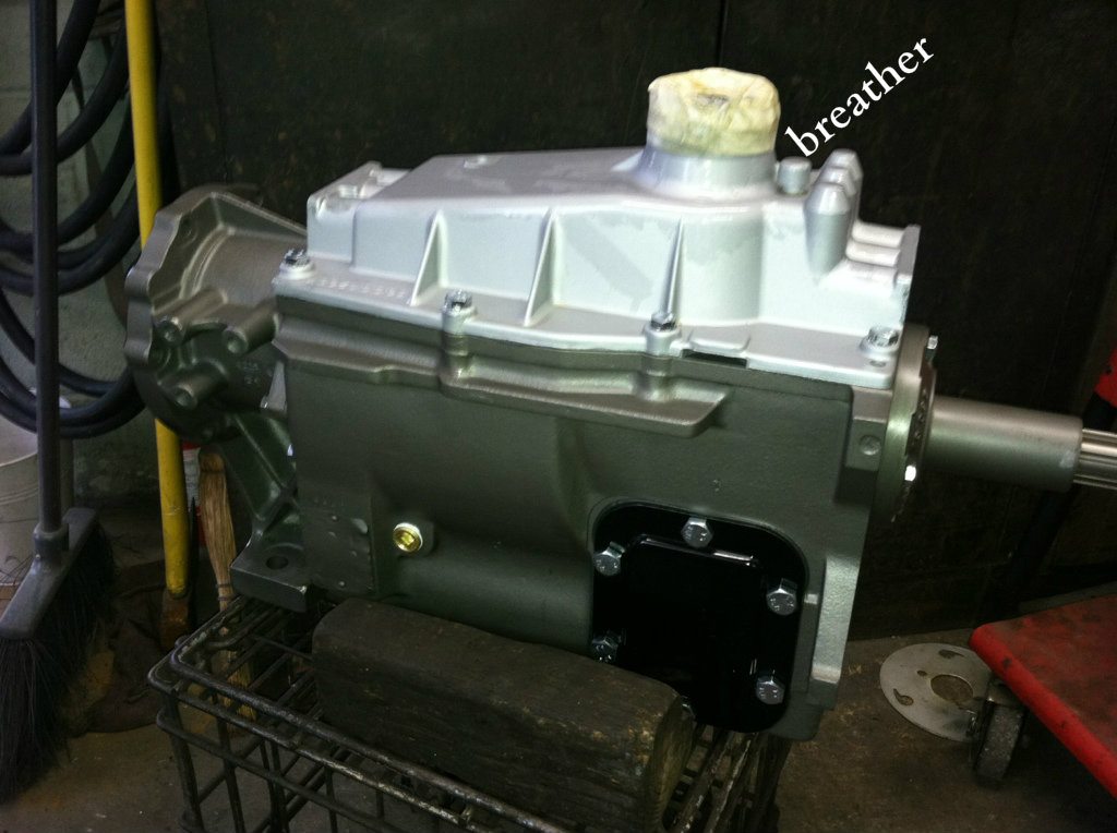

just bought a rebuilt G360 from Jim Clark (was "jjeeper" on E-Bay, now uses "Tristate Transmissions" as his user name). For those of you who don't know him, he's a nice guy in his early 60s who rebuilds trannies for a living. Very pleasant to talk to and he ships Getrags all over the world.
Jim ships all of his G360s with five quarts of Mobil 1 5W30, which is available at Walmart for about $22/gallon.
He told me that the seals are NOT stressed by the extra oil, that there's a breather just forward of the shift assembly that relieves excess pressure
He is right, this transmission uses the gears to lubricate itself. There is no oil pressure or sending unit in the 360. The seal is metal coated with viton. The newer kits use a better compound. I wouldn't worry about it, no way it's going to leak unless your shaft is a bit loose
