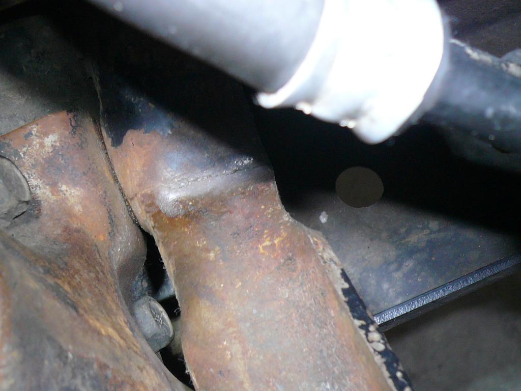

Originally Posted by diesel402004
Looks like the 93 in sig. has started to crack. Has anyone mounted the dodgeconnection brace on their 93? Does the valley in the top interfere with it? It looks like the frame is different than the one on their website.
Question for ya'll. Had the lady turn the wheel while I watched the crack. Clearly flexes the crack open and closed. I have a brace coming and am planning on fix. But in the meantime truck drives the same as always straight and true just like the last 24K. It's not affecting the driveability. Point is I'm doing a long road trip for the next week and don't have time to fix before trip. Has anyone just had their front end collapse while just driving down road? Ya know have the spring shackle or steering box just fall off? Not wheeling or anything, but just normal driving. Thinking I can get away with it for just a little while longer, since it's probably been that way for awhile anyways.

Had a 76 2wd that I bought from a friend. It started as a crack in the same area, then worked its way through the frame. He ditched it when it broke and wouldn't turn when the frame was under tension. It would stretch when turning one way, but would turn when the frame was in compression.
Does the crack run to the bottom side of the frame?
If not I wouldn't worry about it.
