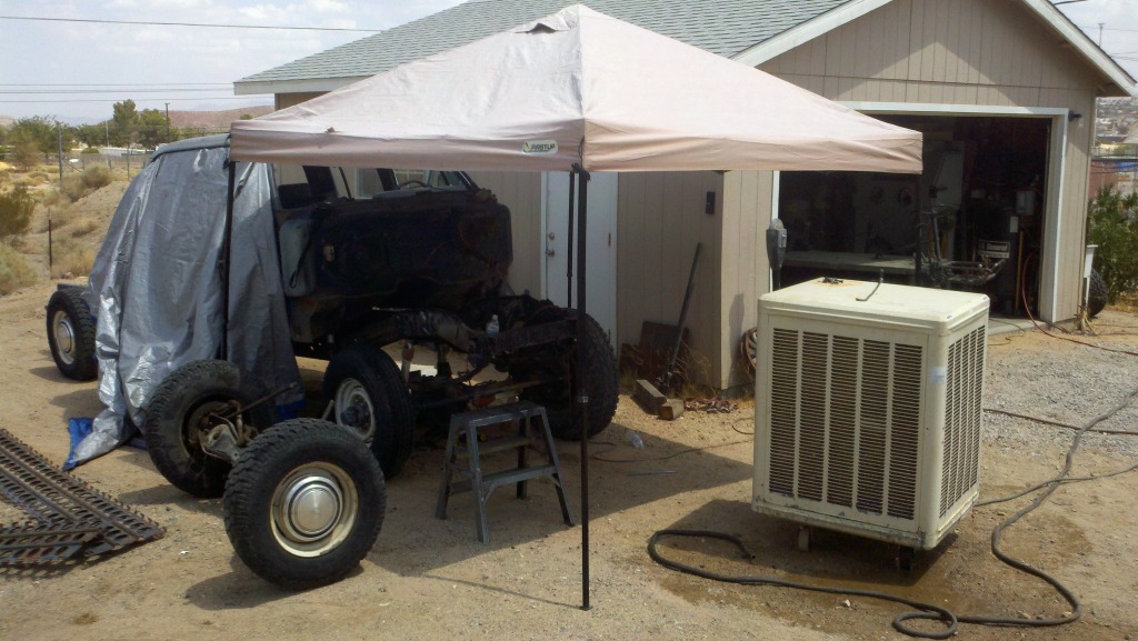

Size:  212.0 KB this was this last weekend worked Smarter not Hotter it was only 110 out side in Sun frontend is completly under truck n mounted next step is wiring and setting motor N trans into truck .

Well with the shade and cooler it was alot less when I was working on the truck weather it was up top or under it it was Nice More to be done on Sunday

cool project did it already have the front spring mounts on the frame? I've seen some older 2wds that did.
