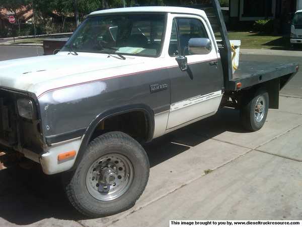

I purchased a New to me Dodge truck, I had a lot of positive experiences with this site when I owned my 2001 24 valve. So I wanted to announce my return with my first gen. I have been lurking around a bit and checking the FAQ thread out and fixed a few things already. The truck has 250k on it but runs strong and I have high hops for the truck. My first question is the 4X4 engaged light doesn't light up when put into 4X. I found what I believe is the correct sensor, on the top of the transfer case and on passenger side of it. There are no wires ran up to it but there are 2 hanging under the truck laid on the cross member. How do I find these wires to run to it and what can I do to the wires under the truck that would light the engaged light up to check? Sorry for the long post, any and all help is appreciated. I will post some pictures up when I can

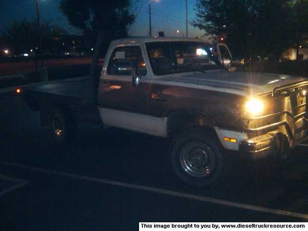

She needs some work but I am very happy to have her and am looking forward to fixing it up
