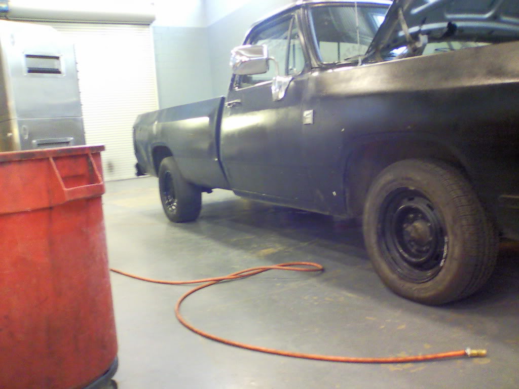

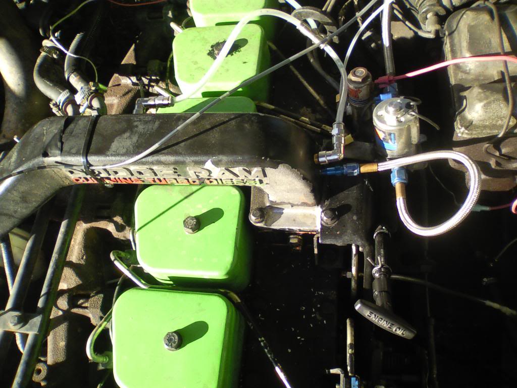

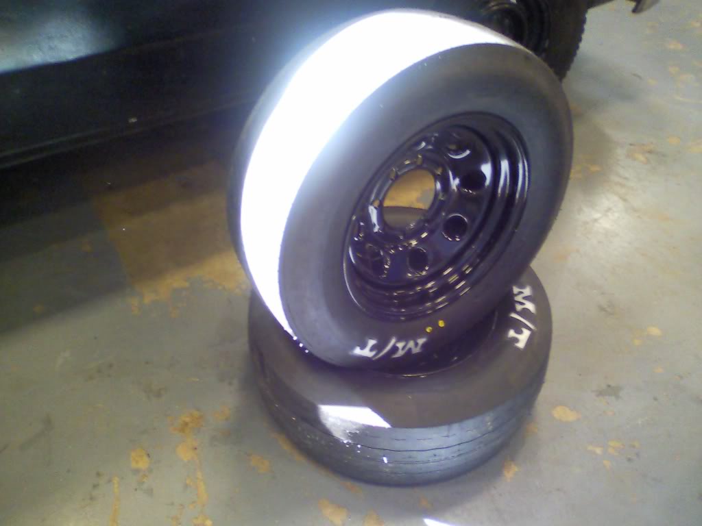

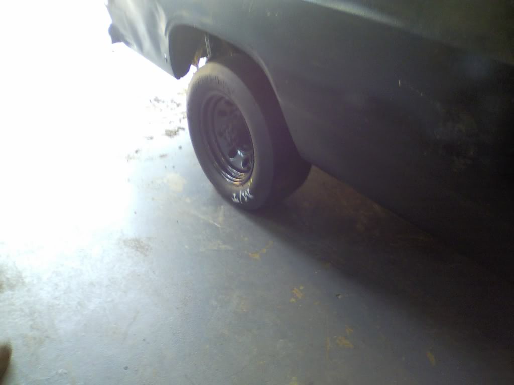

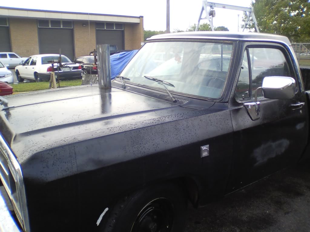

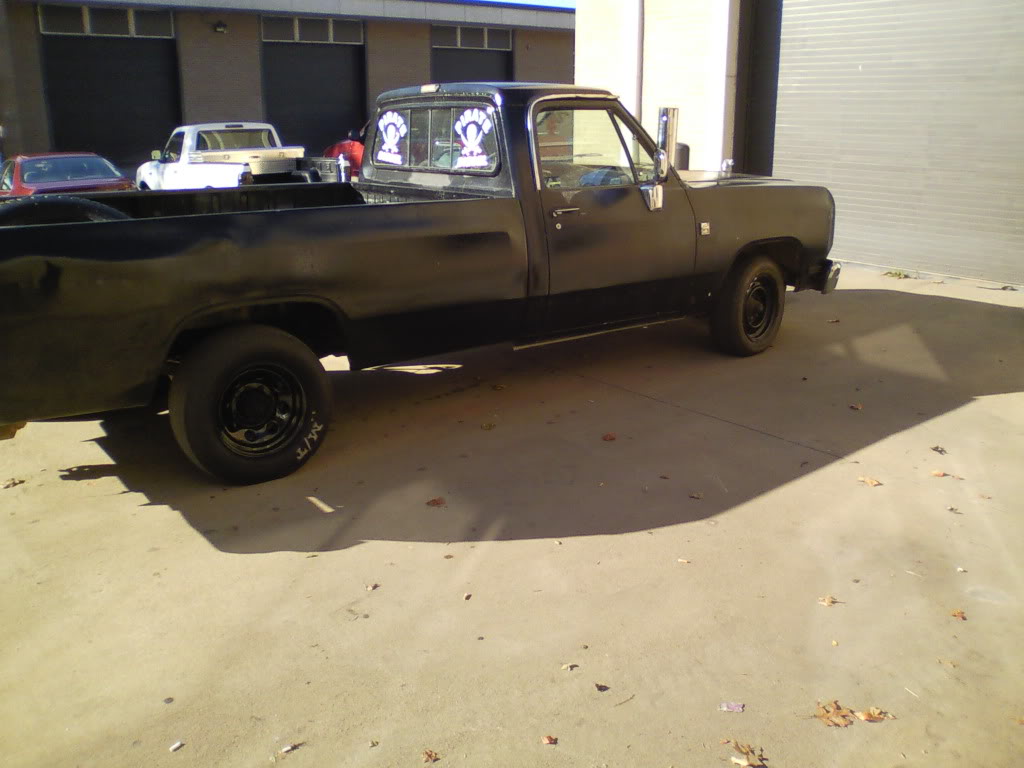

I have been a 1st gener for a couple of years now and love to consult this forum for any questions I have. Fortunetly most of the questions I have had are already answered so I havent been much of a poster. Now I am working on a strictly "race" truck. Four 1st gens later I am now in a better position to play. I have tweaked on them all a little but nothing like I have in the works for this one. I have a few picture of the work done so far I bought it a fixer upper and it is now well on its way. Its a 1989 5speed bought it for $1800 with a leaking injection pump, blown turbo, missing driverside motor mount, and only 1 brake working. Within the first few days I replaced the motormounts, front rotors, brake pads, driverside caliper, fixed non-working tailights/brake lights, new h1c from a 93 truck, and got it driveable. Now for the good stuff..... (already on) 16x8 powedercoated wheels on the rear with 28x11.5 mickey thompson et streets, 215/65/16 front tires on the cleaned up painted stock wheels, 3in lowering schakles, 5in hood stack, and some Pirate diesel stickers..... (going on next week) big water meth kit, 60mm gds, 16cm housing, brand new injection pump flow benched to the maximum fuel screw, 3/8in fuel lines from intank draw straw to pump, holley blue for lift pump, pump to head, boost gauge, and egt gauge..... Depending on how all of this goes, what you guys think about it, and if I am happy with the outcome then I will asses the next steps to take. Let me know what yall think and I will try to get some more pictures of the truck and goodies.
Thanks for listening to me babble...

Nice looking truck. How is the hood stack pipe held on, I mean is there a pipe coming off the turbo and inside of the pipe I see out of the hood? Reason being that I could see the motor torqing the pipe and bending the .... out of the hood. What are you doing about a fuel cone/pin?
Old Oct 4, 2010 | 10:33 PM
Johnelliott52's Avatar
Joined: Oct 2010
Posts: 10
It has a pipe off the turbo going into the stack on the hood... I want to get a denny t II but Im just gonna rotate it for now. Like I said this is just a starting point. I know a clutch is going to be a much needed upgrade once I get it all buttoned up tomorrow... I didnt quite get all the new fuel line, lift pump, and injection pump on this morning before I had to go to work so I havent even got to play with it yet. Might try and take it to the strip this weekend if the clutch holds messing around on the street. I should be getting my gauges in tomorrow aswell so I can monitor everything properly. We'll see how it all goes.

Looks like a great truck. Hope you have a Posi in the rear or else those slicks will be useless.......been there done that.

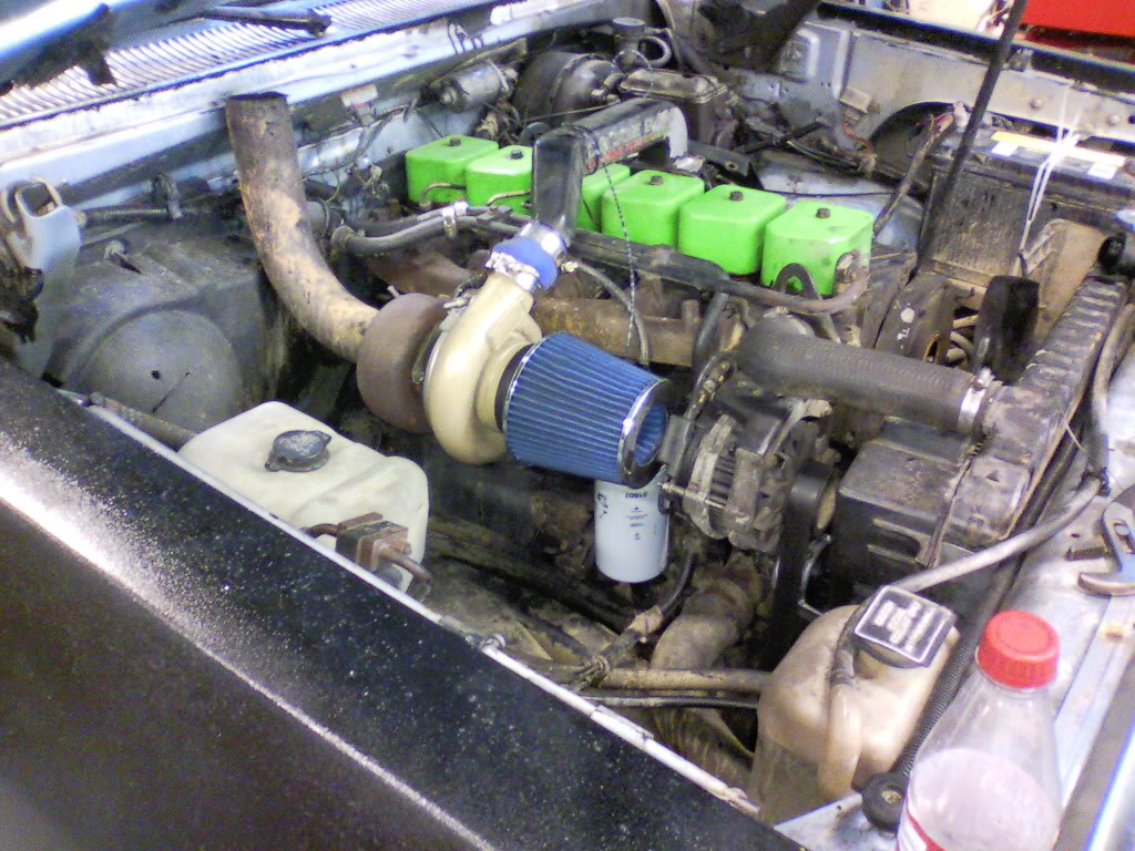

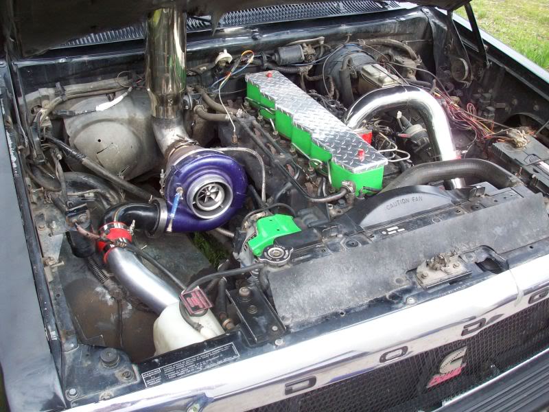

Heres just some more pictures. Didnt quite get it all done today :-/ really fustrating. I should have it done tomorrow finally. My gauges came in today though so it wasnt a total bust.. Kinda curious about my fuel pressure though, It pegs out my 15psi gauge when I turn the pump on before I try to start it. You think it will be a lower psi idling?

cool project and welcome to the hood stack club
your valve covers look like mine

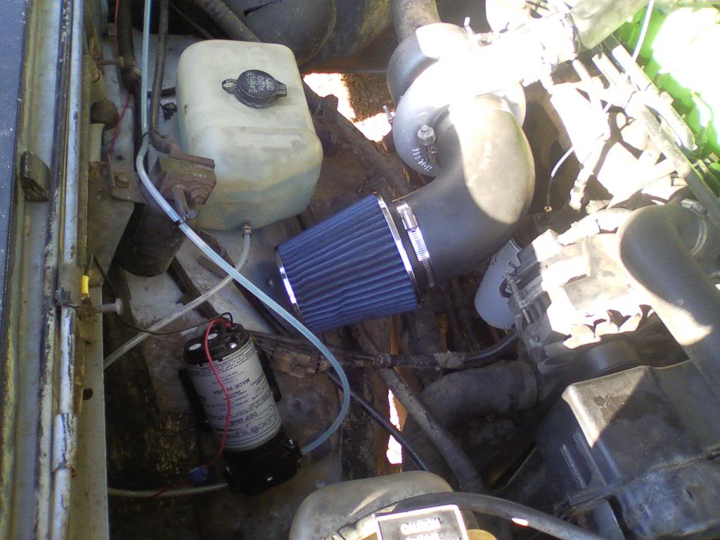

Well got the 60mm GDS compressor wheel and the 16cm housing on today spool is WAY better and it sounds alot meaner. While I was in there and feelin good I had a spare grid heater laying around so I gutted it and threw it on. I also installed one water/meth nozzle and turned the fuel screw in a turn, the fuel pin to the maximum travel, turned the star wheel in all the way, and installed a lighter weight spring in the afc. Test drove it.... WOW what a differance, its almost monster status SO seeing as how that wasnt enough i put the other water meth nozzle I had in there too... Even more monster mode... Needless to say Im very pleased, gotta ease into it though because it has no problem slippin the clutch... Upgade time

Sorry its been awhile since a post Ive done quite a bit since last time but heres a little. I finally got the timing straight, and its running great, boosts more than ever and has a smooth power climb all the way up. I am in good with this machine shop and they're making me a spacer like engineered diesel for my 50mm wategate. Since I didnt have the wastegate on yet I was a little nervous to put the spray to it with the .073 nozzle so I put in my .038 nozzle and decided to give it a go. Holy geez!!! I know that shot sounds real small but with the big selinoid, lines, 900psi in the bottle, and coupled with the water/meth it is impossible to even think about getting traction. I have the water/meth and nitrous both on boost referance switchs. The water/meth comes on at 10lbs and the nitrous comes on around 20lbs. Hits at or a little below 50lbs of boost and you better hold on.. Needless to say I am very happy... hope it doesnt blow the head gasket but even if it does its good to know I have a .068 copper one waiting to go on. Hittin the track tomorrow and I'll let yall know what it does, theres this 6.4 powerstroke boy with a bullydog, exhaust,and intake that is gonna be there too.. I'll see if I can whoop up on him a little if I can shift it fast enough.
