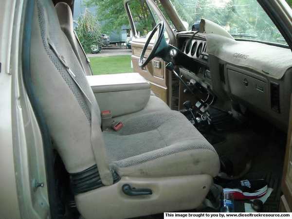

finally got them in way more comfy than the old broke down bench if any of you are thinking of doing it it is well worth it

did you have to make custom brackets?

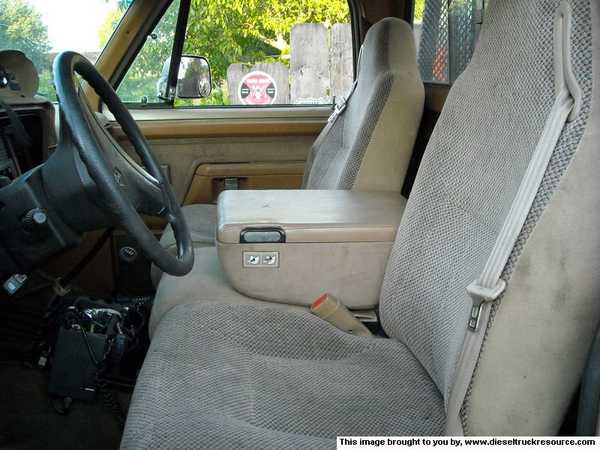

ya i took off the old ones and welded up a square angle iron frame around the seat tracks in the 2nd picture you can see how i secured it to the floor the back bracket i bolted it into the old seat belt hole for more strength in a crash
