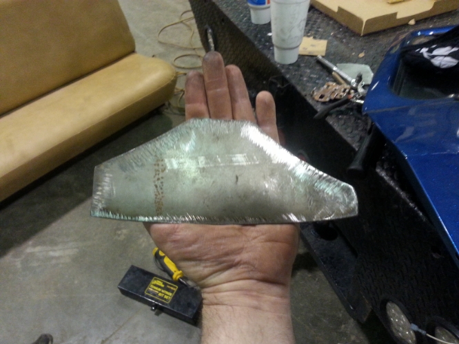

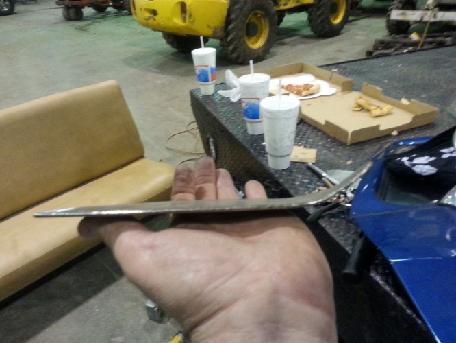

Old Jan 18, 2014 | 05:50 PM
enydick's Avatar
Posts: 131
From: wichita ks
so here r some pics of how i fixed it
needing help with lower door hinge crack repair-20140113_121618_zps6bce49ea.jpg
needing help with lower door hinge crack repair-20140113_121638_zpsab223796.jpg
needing help with lower door hinge crack repair-20140113_121641_zps727f1904.jpg
needing help with lower door hinge crack repair-20140113_123155_zpse2ee965d.jpg
