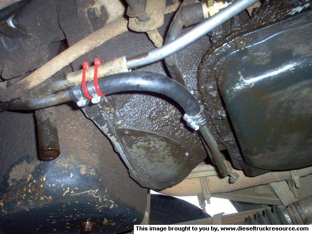

I have also discovered that one of my tranny hard lines has a hole it. and a previous owner did a terrible fix - he used a hose clamp and a piece of rubber to plug the hole. I found that the hard way - I removed this random hose clamp and tranny fuild started leaking out.... anyways it took me probably an hour to get that plugged back up. So now I'm going to have to figure out a way to fix that right. I'm thinking about just cutting the hardline and installing another tranny cooler in that location since I hear those hard lines are really expensive and I've been wanting a bigger tranny cooler. for now I just put a new patch on that line like the previous owner did, I hate the idea of doing that but atleast now its not leaking.

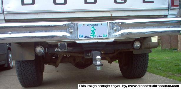

I got a front chrome bumper for $35 from a buddy to replace the badly bend one that was on teh truck. I also got a rear chrome step bumper from a wrecking yard for $50, also to replace the badly bent rear one. Those installed fairly straight forward and actually made the truck look normal. I did beat most of the dent out of the bed corner because the old bumper push it in.

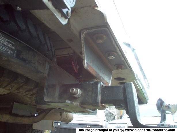

I also beefed up the reciever hitch by making a bolt plate that I welded to the top of the hitch that bolts to the factory receiver ball holes in the center of the bumper. I'm confident now that I won't ever have any issues with this hitch.
At the same time I also bought a nice drop receiver stinger (up to 10,000 lb trailer) and a heavy duty 1 1/4" shank, 2" dia ball (rated up to 7,500 lbs) to match the coupler on my tandem axle trailer (7K rating).

I also wanted to do something about the crappy back up lights. So I wired up a relay, which is mounted in behind the driver side rear tail light, To power two 55W utility lights bolted under the rear bumper. I also ran this a relayed power wire to the Aux port on the 7 way trailer plug which will be wired to two more 55W utility lights bolted behind the rear axles of the car hauler trailer. That will make backing up in the dark MUCH nicer!
I also finally got around to repairing that tiny hole in one of the tranny cooler hardlines. I just cut out the bad section and replaced it with a piece of 1/2" tranny line with a couple hose clamps. Then I used another piece of hose to insulate the hard lines from rubbing each other and zip tied them to each other. Seems to be working fine so far, But I haven't really driven the truck much either.

New rear bumper and back up lights.
Re-enforced reciever hitch and Bumper and 33" spare tire.
Tranny Hardline Fix
