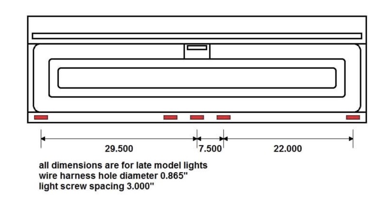

I need to put the 5 marker lights on my "new" tailgate. The old tailgate was stolen before I could measure the spacing. Could somebody who owns a Dually please measure them and let me know?

Here's a schematic I had saved a while back, it was taken from Tcow's thread on the install of the lights: https://www.dieseltruckresource.com/...ements-319739/

Thanks so much! I owe you a cup-o-joe. When you coming down?
