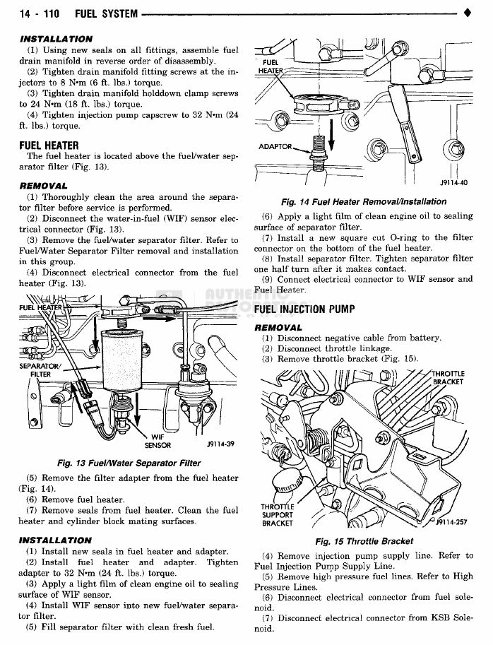

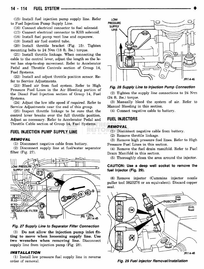

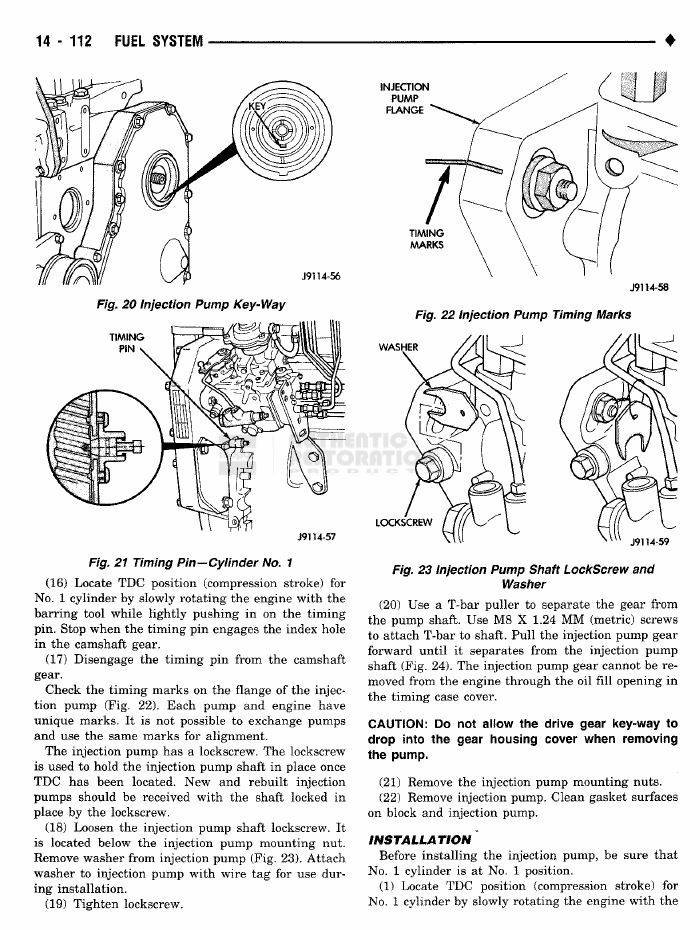

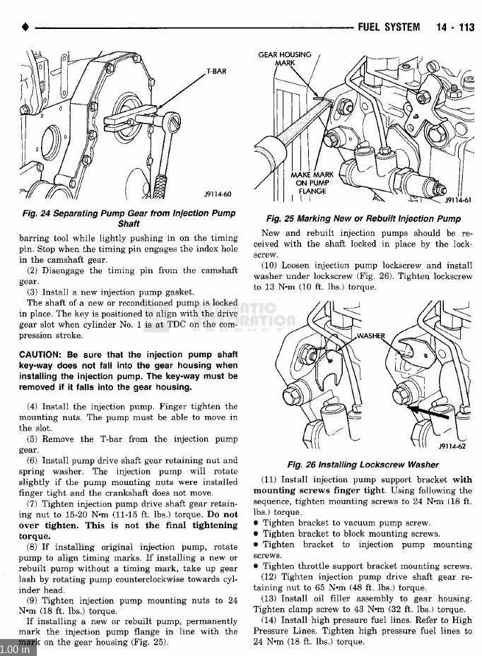

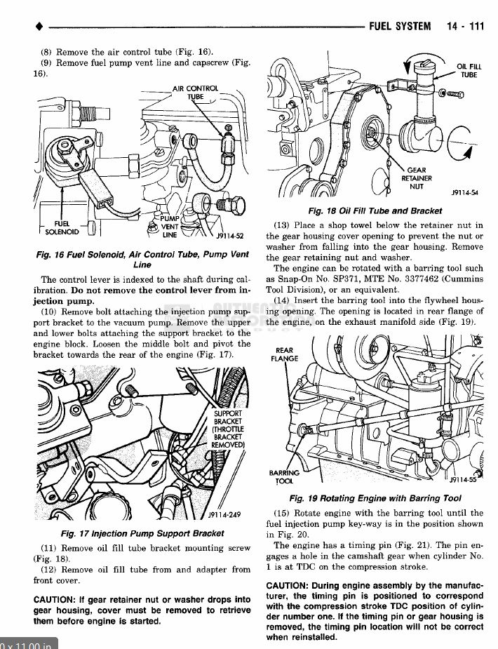

From the FSM here are the removal and installation procedures for the fuel injection pump on our trucks.
Hope this helps.
