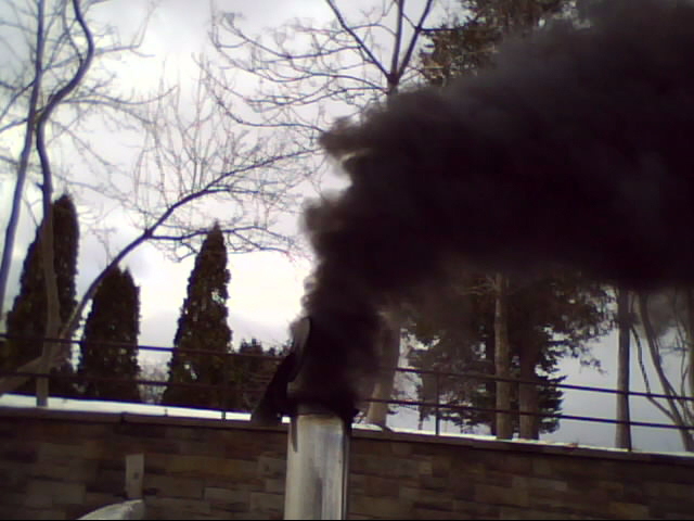

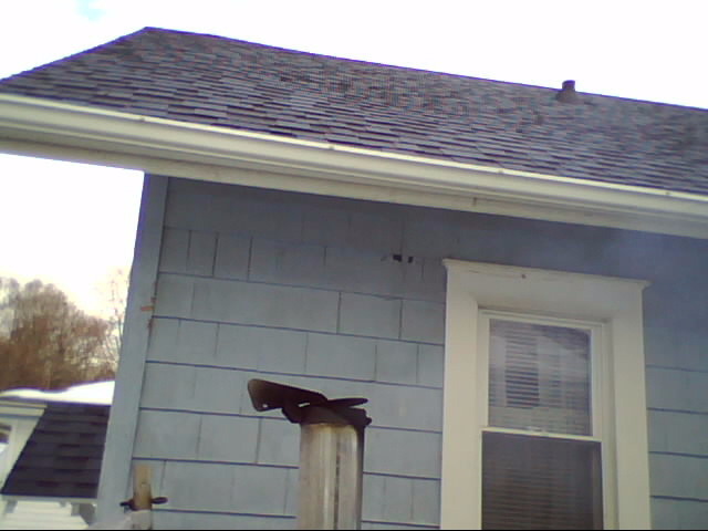

Been waiting for a 'clear' day to get some pics of the M2 in action....
Remember the pics are made with my heavy ( ~ 35lbs compressed ) afc spring so there's not as much smoke as I'd get with the stock spring which compresses at ~ 18 - 20 lbs....
1st pic is right after cranking - I missed the puff of black smoke that came out. If you look close you can see the haze...
2nd pic is in motion on a side street heading toward the main street, lite throttle and ~ 25 mph. Just slightly more haze than at idle. This is normal for town driving.
3rd pic is hiway. Just took a fork and the car in front of me decided to slow down to 50mph. As soon as I saw clear road in front of me I floored it and then reached over to the computer to catch this. I was up to ~ 60 and rapidly accelerating. I backed off at when I saw 75 mph and still pulling strong. I hit ~ 35 psi here.
Pulled the fuel pin when I got home and the track was just at the flat of the pin.

You smokey boy you!

global warming is all because of you. i'm proudly contributing to that myth by filling the hole in the ozone layer
