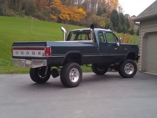

6in full bolt on skyjacker and mine did sag over time not enough to rub or anything just mabe an inch or so

Dude, that is one sweet ride....did you install it or have a shop do it? Les Schwab Tires here won't do them...I have heard so many sides too the skyjacker....what is your opinion?

me my brother and my dad did over two weekends it wasnt horrible but it wasnt easie either. just when you lift these old girls you must get a borgensan shaft its a must have for a lifted first gen and a should have for any 4x4 first gen. and brandon it is all leafs but the kit came with a block (replaces the factory block) that helps with the diferental angle.

Sweet man....I love your truck. Thanks for the info.
