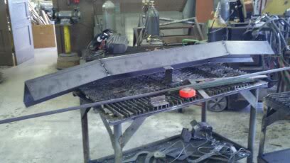

I'm in the process of building mine...
I had a piece of 1/4" plate 7' wide bent so it has a 6" top leg, its 10" tall, and a 2" bottom leg, then I V-cut it and bent the sides with a cumalong and welded them and I did the same with the bottom so it added more shape to it. I'm gonna put some clevis loops on it and probably cut holes for fog lights, I've also thought of making a grille guard that will slide in or bolt in and out so i can put it in through deer infested country or take it off for looks. I hope to be into it under $200 including materials when I'm all done.

92, I'm first in line when you start taking orders for those.
Seriously, though, great looking so far.

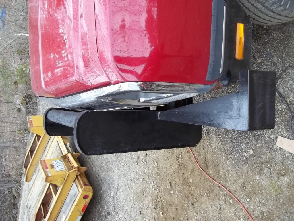

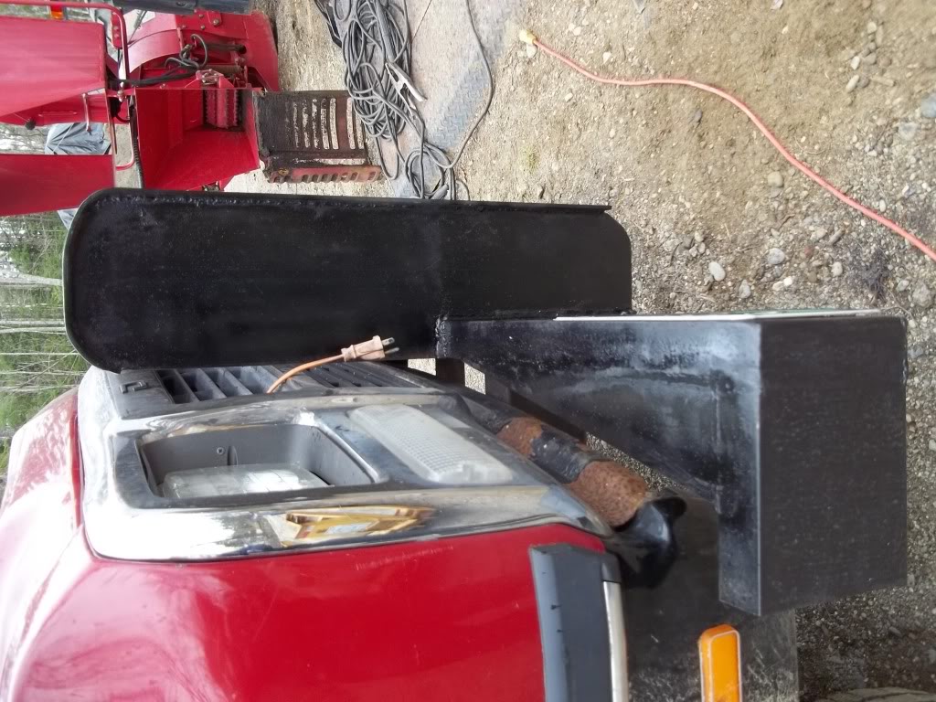

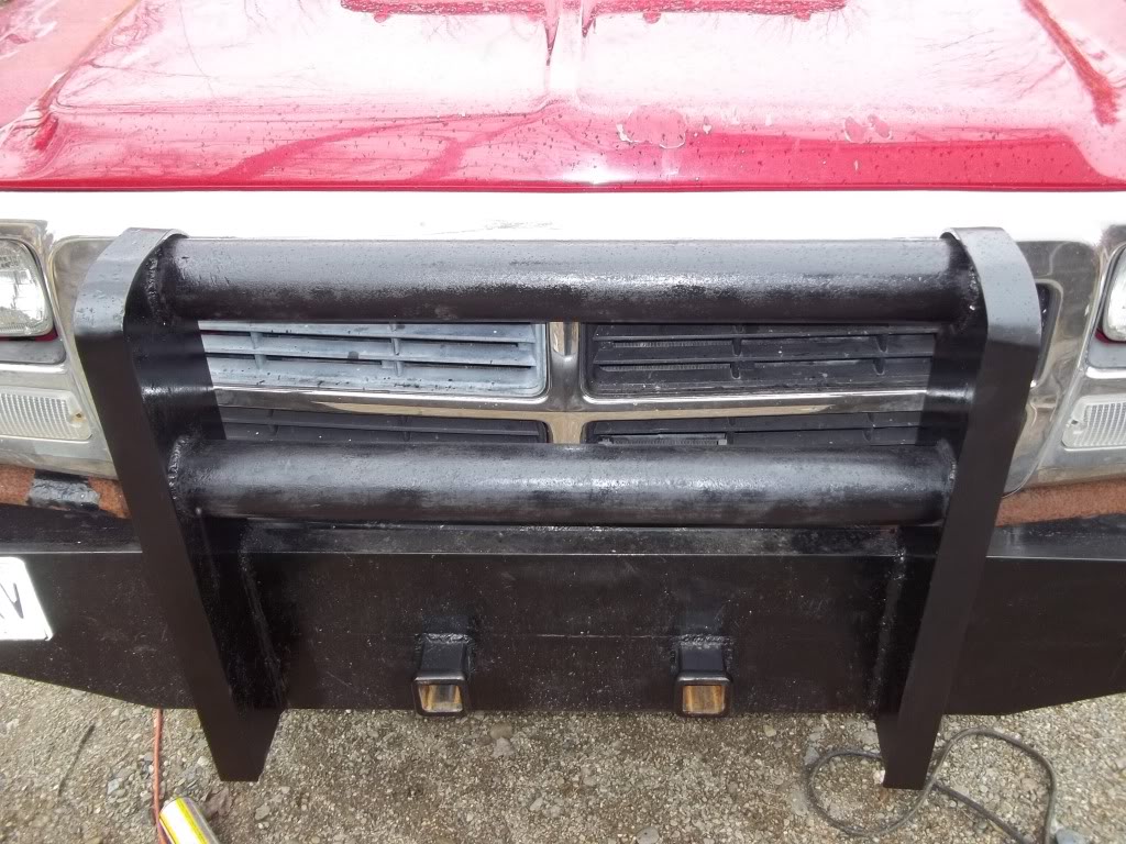

Still have the brush gaurds to build.
