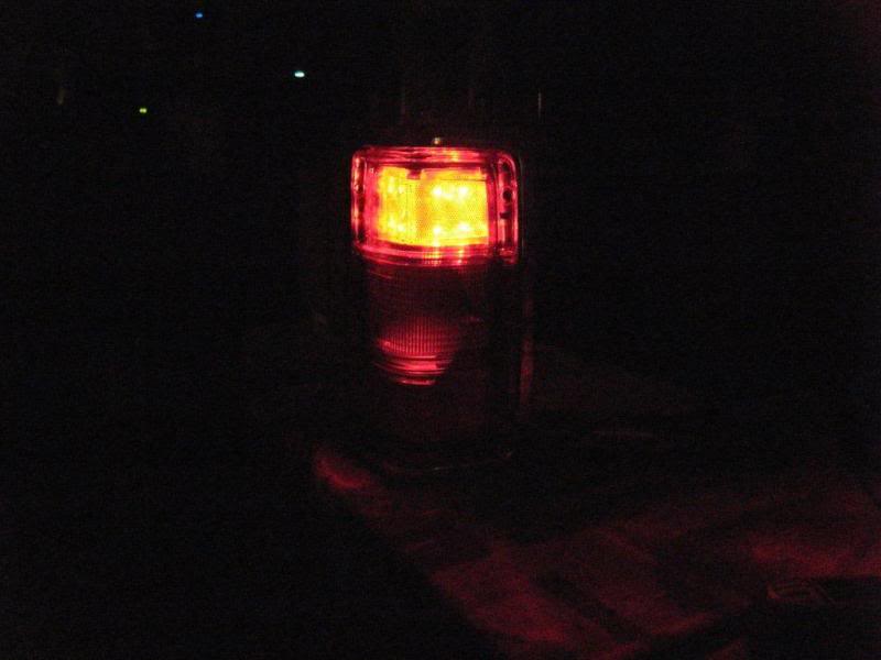

Popped in the LED's and the final effect, dusk corner of the truck shot

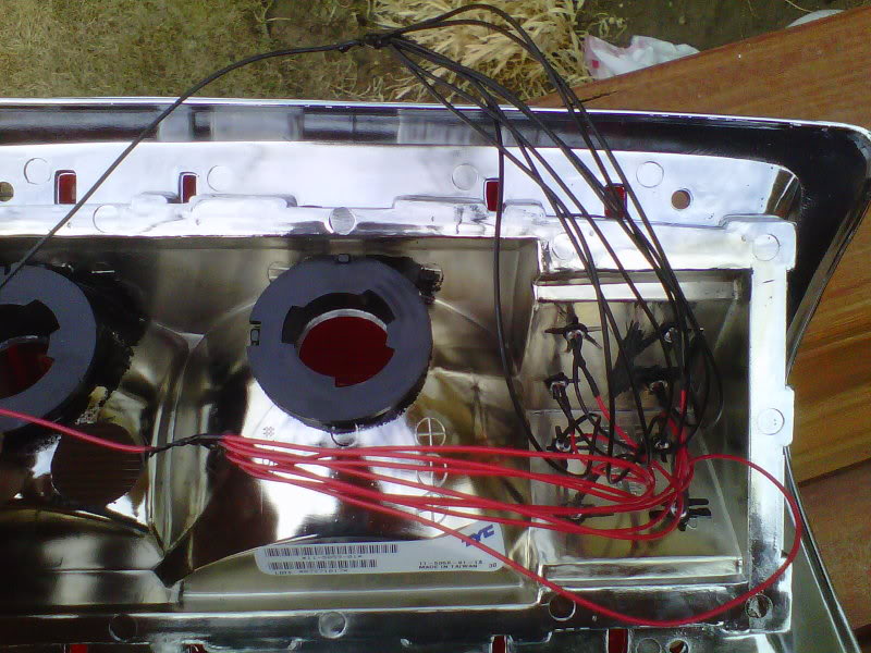

The way the grommets snap in there with the bulb pressing in there is no risk of dust or dirt entering the housing, the LED's are also waterproof so the rears can take some moisture. Picture below of the wiring at the back, all soldered together, brush on electrical tape and then shrink wrap. All 8 leds per side pull 1.8watts so virtually nothing.
I got the housings from rockauto.com
