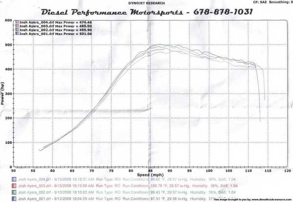

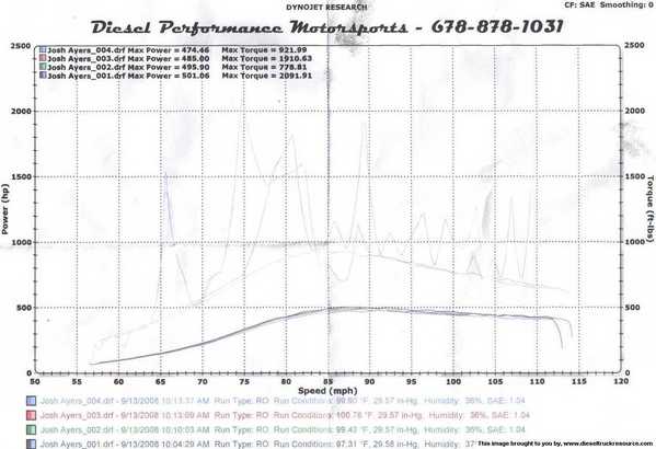

Originally Posted by JAyers
Pump mods at the time of the video, trimmed 4200rpm spring.
Josh you might have already posted it, but if not, could you post a shot of your dyno sheet. I would like to see the graph with that spring.
Old Oct 14, 2008 | 03:20 PM
JAyers's Avatar
Posts: 401
From: Ripley, Ohio
Old Oct 14, 2008 | 03:22 PM
JAyers's Avatar
Posts: 401
From: Ripley, Ohio
This ones alittle messy, they had trouble with their rpm pickup.
Old Oct 14, 2008 | 03:24 PM
JAyers's Avatar
Posts: 401
From: Ripley, Ohio
And if anyone can do the math for rpm, ive got 3.54's and 33in tall tires with the getrag tranny.
