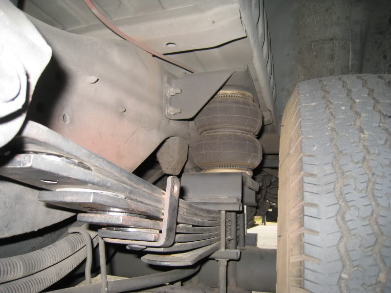

Update!
Today while doing some routine maintence, I was checking the torque of the U-bolts and while checking the springs and I did find that I had at sometime lost one insert but I will report that all of the poly inserts are in almost perfect condition except for the one that I lost.
They have been in service for about 6 months now and the ride is still nice and firm and no squeaks.
This is the back of the drivers side spring pack that lost the bushing; it looks like I need to figure out some way to isolate the clips because where they rub I am getting some rust on the leaves.
Maybe some kind of a graphite paste.

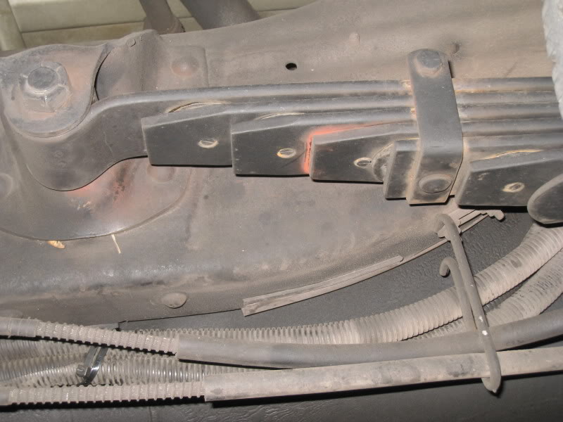

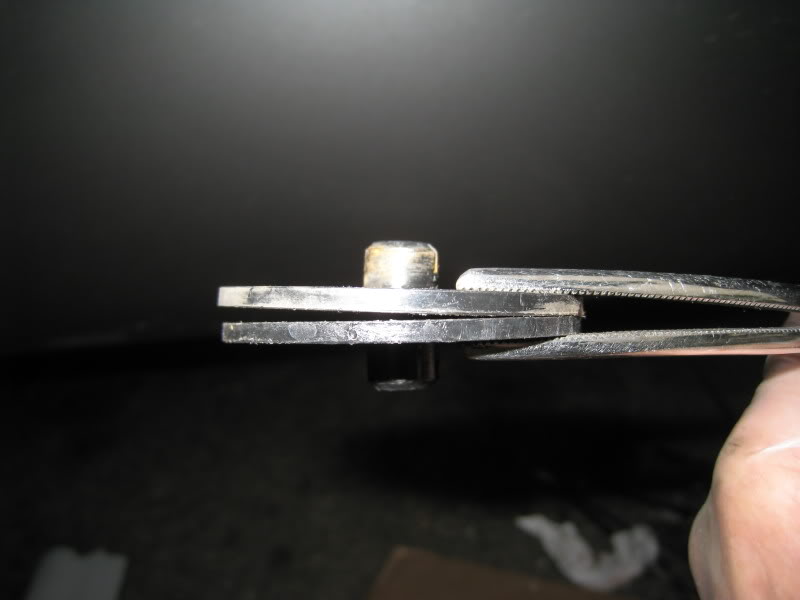

So I will now show you the very difficult task of replacing the missing insert.
First I removed the 3/8” bolt that secures the spring leaves,
Then I pressurized my Firestone Air Bags with 150 PSI thereby removing the weight off from the springs
Now it is a simple task to separate the leaves with a small pry bar, then it is a simple task to drop in a new tip insert.
Then all I have to do is to deflate the air bags, clamp and reinstall the spring hardware and the job is finished.

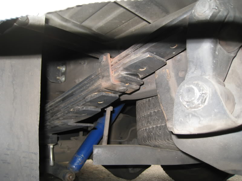

There is a comparison, the old insert on the top while a new one is on the bottom.
About the only wear that I could see with the inserts is that the raised printed numbers on the face was worn off other that that they looked like I had just installed them.
So I think these are going to wear for some time, six months later I am still happy with the improved ride that I got from this project.
