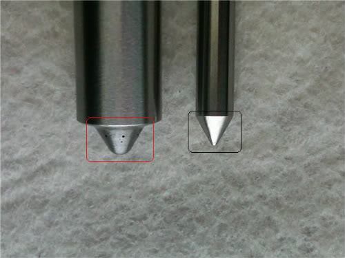

If they're stock type VCO injectors they'll need .096 If they're sacs they'll need .030 or even less.
Sacs are visibly shorter in length.

Old Sep 21, 2012 | 12:54 AM
jimbo486's Avatar
Posts: 4,389
Likes: 114
VCO:
Sac
