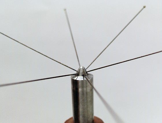

are there any numbers on the injector tip?
185 pw injectors have 5 holes stock intercooled have 6 holes and PODs have 4 holes can also tell the POD injectors the holes are closer to the tip.

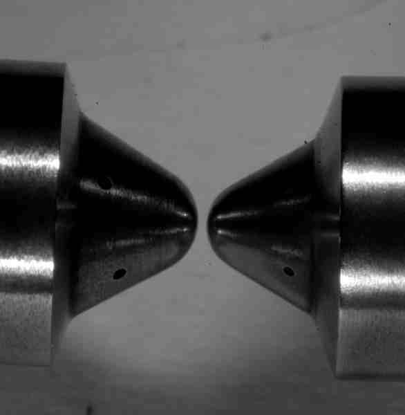

alright so i went and looked at the injector to find something odd, it has neither high nor low holes, its goes, 1 high, 1 low, 1 high, 1 low. i wish i had a good camera to show this, but heres the number on the injector itself,
KDAL 59P5 692 14
245 BAR
and the box they came in looks like this

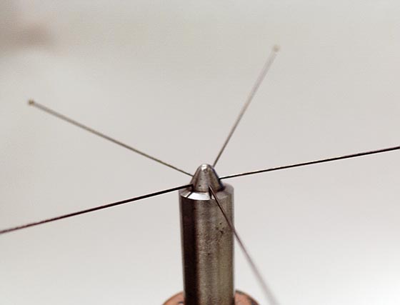

Most of the injectors for our heads are in line but off axis. this is to account for the mounting angle of the injector. ends up spaying at a slight down angle into the piston bowl.
