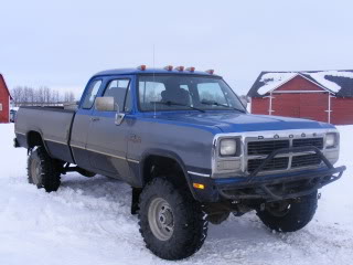

Old Nov 3, 2010 | 06:26 PM
THEBIGBULLY's Avatar
Joined: Sep 2010
Posts: 210
From: Alberta, Canada
I fab'ed a 3" body lift on mine.
I wanted to increase airflow through the radiator.
I have new springs in the truck so no need to get new higher ones.
I took out half of the leaves in the back packs and added suspension bags rides like a half ton but can haul the weight of a one ton.
Works good so far.
Tires are 35" Thornbirds
