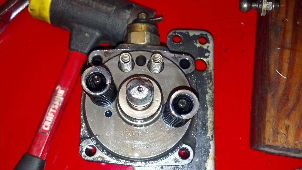

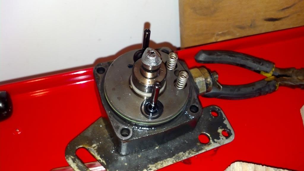

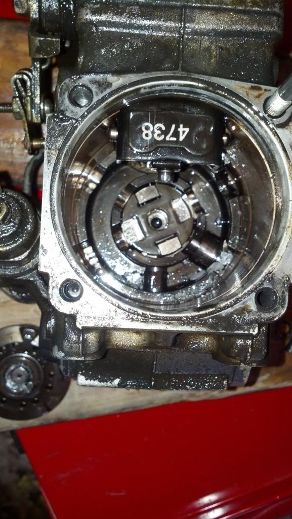

The head broke off the shaft and is stuck in the cam plate. The rest of the shaft is locked up in the head. When it happened it broke 3 of the 4 bolts that hold the head to the pump.

93-12Smoke's Avatar
Posts: 1,751
Old Jan 8, 2013 | 03:45 AM
93-12Smoke's Avatar
Posts: 1,751
By toast i mean I'll probably have to eat a core charge. I didn't remove the screw from the head and try to push the shaft out but it's stuck in there good. The shop it's at now was going to try and remove it and see if the heads salvageable.

Pump shop just called and confirmed the head and housing are damaged. Talked with Giles and like you said he i would have to find another core to build with.
