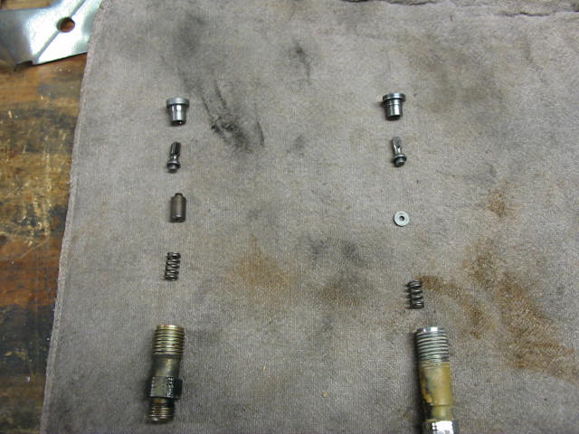

Not exactly.
Delivery valve
The delivery valve closes off the highpressure
line from the pump. It has the
job of relieving the pressure in the line
by removing a defined volume of fuel
upon completion of the delivery phase.
This ensures precise closing of the injection
nozzle at the end of the injection
process. At the same time, stable
pressure conditions between injection
pulses are created in the high-pressure
lines, regardless of the quantity of fuel
being injected at a particular time.
The delivery valve is a plunger-type
valve. It is opened by the injection pressure
and closed by its return spring.

If you look at this picture, you will see 2 delivery valve setups. The one on the left is from our engines the one on the right is from an industrial version. (Dont get any wild hairs about going to an industrial style as it has already been tried, LOL) anyway, the one on the left is what you will find if you take the valve apart.
