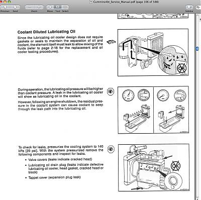

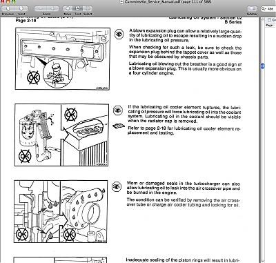

Found something interesting in the Cummins B series manual I have in PDF. Check out the images from it I attached. Describes symptoms exactly. Oh yeah, Thomas, I'm mailing this PDF to you right now. Check out section 2 page 2-11
EDIT: Shoot, the PDF is too big to email. I'll try to find where I downloaded it from.
"A leak in the lubricating oil cooler will show as lubricating oil in the coolant.
However, following an engine shutdown, the residual pressure in the coolant system can cause coolant to seep through the leak path into the lubricating oil."
