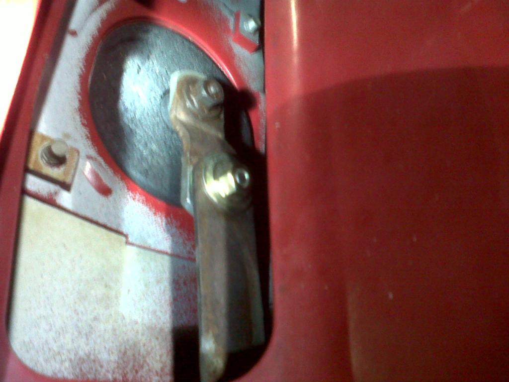

I had this happen to me in the middle of a terrible rain storm. I just decided I didn't want this to happen again. I decided to fix it with a bolt. I'm pretty sure it will never break again. Fairly easy fix, I had access to a grinder, and a drill press which made it fairly easy. You don't need a drill press, you can use a handheld, but the grinder was a necessity.
