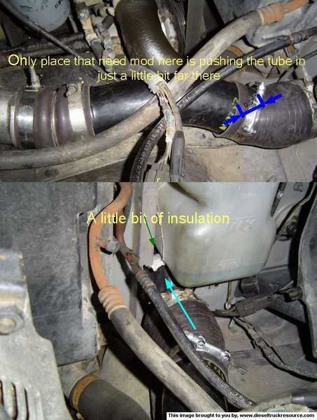

Hot side done with vary little modification required! Were indicated, need to be push into the boot ½" further then stock
Now for the filtered air..........the factory air box can be use..........However the part that the filter hooks on to, will need to be swamped out for the intercooled version, as well as the rubber tube that go's from the air filter to turbo. If you want to "delete" this step and go directly to a “BHAF”(instruction found in Sticky) then non of this, is of impotence.

Now the driver side.........How are we going to avoid all the work it is going to require to get it from the intercooler to the heat grid or intake.................................
Well if you use the factory boots, clamps and a second (R) tube, you're half way there. The right side tube is shaped perfectly to maneuver around the battery tray on the (L) side or drivers side. The factory upper boot go's on top of that.............................................. .................Now how do we get it from there to the intake

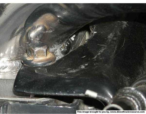

First off, you will notice that one of the bolt holes that attach's the CoolerTubz to the intake heater isn't a hole,...... but a slot instead.
In order to make a nice air entry.......and still clear the master cylinder, as well as the hood. The tube needed to be layed forward, toward the front of the truck more then all of the other tube that Tim had made previously.
The big problem was that Tim and i live a grate distance apart and hence required the mail back and forth of this produce before a final weld and polish could be done........Getting off track here..............
To install the air horn, you will need to install one of the bolt before you install Tim's Intake Air Horn "CoolerTubz"
then just slip it underneath it. Don't forget the gasket!
But there is more, the stock air horn has a thicker flange then the new Air Horn.
For the back bolts,(next to the head) this is not a problem as the bolt go thru the intake into the head. or into the intake its self(recommend using thread sealer here)
the outer ones(toward L fender) do not go all the way thru, and the bolt will bottom out before it gets tight. you can us a shorter bolt on these two but the throttle linkage is also attached to these same bolts........................... So you could cut the ears off of here and us shorter bolts( not advised as that would only leave one bolt at the bottom)

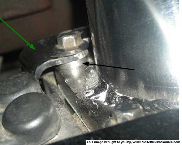

Note yellow, black, and orange circles below
The Red is trying to represent the u shape that you need to grind on this bracket to clear the large 3" tube. the blue arrow is pointing to the washer that you can't see here but you will as the pic are added.
Note: If I was going to do it again.... i would remove every thing in side the black circle and us a shorter bolt..........this means that there would only be two bolt holding the throttle bracket(yellow and orange) but i thing that is enough to hold the bracket solidly................and would allow much more ease, of bolt aboves tightening
Have no idea why i put the green arrow in above
This green arrow above represent the bracket and the spacer that i installed under it.
And as you can see, three (3) picture up or above^^^ is the spacer i use on the other side.......If i had to do it again i would us a shorter bolt there.
Below is a picture of the stock bolt and spacer, i use on both sides.........and the shorter bolt that i will use with out a spacer on the next one or, if i ever need to remove the air heater or something
